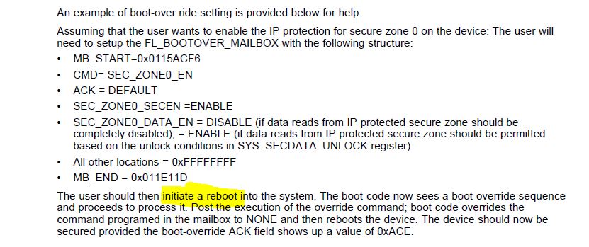

  • Hi David,
    I looked at the C file you posted.  It looks like you're using Port0, Pin5 as the BSL invocation.  Is that correct?
    So my question is: unlike the FR5969 (and other MSP's), if I get a blank MSP432P4xx from production, never been programmed, I cannot use the BSL H/W Invocation since its all F's??  If so, why is the appNote SLAU622 on page 16, Figure 6 showing P1.0?
    Also, second question. I've changed the msp432_flashmailbox.c file to add the Reserved bits of 0x1f to the  invoke parameters and noticed under Code Composer (CC), they show up as zeros.  When I'm using IAR EW 7.60.1 version, I cannot see the data at all.  It's all F's
    Could you expand on why IAR cannot show the BOM and CC can and why CC cannot show the Reserved bits as F's
    One more thing, with the file you posted, I still cannot get the BSL to talk to the BSL_Scripter.exe version 3.1.0.0.  I assume I should be using P0.5, pulling it high while holding the RSTn switch on the Launchpad dev board?
    -Jim
    Additional:
    It appears I can get the CC (version 6.1.1.00022) to show the correct Flash Mailbox data at address 0x0020201E8 by powering down the Lauchpad.  But just by changing the data of the BSL_PARAMS, cleaning, rebuilding and downloading, does not show the updated data.
    That said, I'm following the code example of AppNote SLAA659 and notice when I pass in COMMAND_BSL_CONFIG (0x00020000), the code (result = BOOT_OVERIDE_OPERATION_FAIL) returns failure:
            if(flashMailboxCommand & COMMAND_BSL_CONFIG)
                if(*((uint32_t*)(ACK_BSL_CONFIG)) != 0xACE)
                    result = BOOT_OVERRIDE_OPERATION_FAIL;
    Here is a copy of my Boot Override Mailbox (BOM):
    Do you see any errors as to why I wouldn't get an 0xACE (ack)?  As a matter of fact, I do not even know how the ACK (0xACE) even appears in the BOM address offset of 0x1F4.
    FlashMailBox
    0115ACF6      00020000      FFFFFFFF      FFFFFFFF
    FFFFFFFF      FFFFFFFF      FFFFFFFF      FFFFFFFF
    00000000        00202000      7C48DF50      FFFFFFFF
    FFFFFFFF      FFFFFFFF      FFFFFFFF      0011E11D
    This is what I assume: 1.) The H/W invocation of getting into the BSL from toggling RST/Port_X.X is not available (like on the other MSP430 micro's) because the BOM comes from the Factory erased and needs to be JTAG'ed with code to put in (stating the BSL_PARAMS to act upon).
    I still cannot BSL the via P1.5 on the Launchpad (0x7C48DF50). I also cannot see the data at address 0x00200000 using IAR.  I can see the data at said address with the same compiled code using Code Composer.  Maybe there is a option in IAR I'm missing (and yes, I've read the SLAU574C appNote).
    Any ideas or help appreciated.
    -Jim

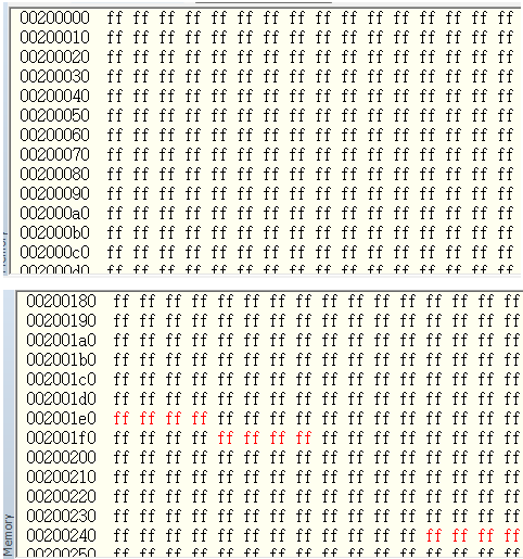

    The reason is because the ROM boot code is not being called, so you will need a different class of reset (POR/Reboot - please take a look at the RSTCTL chapter in the Technical Reference Manual). So please change your code to:
    #include <msp.h>
    #include "flashmailbox.h"
    #include "driverlib.h"
    volatile bool forceReboot = false;
    int main(void)
        volatile uint32_t i;
        WDTCTL = WDTPW | WDTHOLD;               // Stop watchdog timer
        P1DIR |= BIT0;
        if(CheckAndEraseFlashMailbox(COMMAND_BSL_CONFIG) !=
           BOOT_OVERRIDE_AND_MAILBOX_ERASE_OPERATIONS_SUCCESS)
            while(1)
                for(i = 0; i < 10000; i++);
                P1OUT ^= BIT0;
                if (forceReboot)
                	MAP_SysCtl_rebootDevice();
        else
            P1OUT |= BIT0;
        while(1);
    "MAP_SysCtl_rebootDevice" should perform a reboot and the ROM boot code will be called.
    Yes this is correct, but by default if the memory is erased, the BSL will get called.
    1. Please make sure that you are using the PARITY on the MODE
    2. Try again after you erased the application flash
    3. Confirm that the BSL has not been erased, read location 0x00202000
    4. Confirm that your Mailbox has the correct start address and it also enables the BSL
    /*-------BSL Configuration Group-------------------------*/
        /* BSL Enable
         * 0xFFFFFFFF: Disable
         * 0x00000000: Enable */
    //    0xFFFFFFFF,
        0x00000000,
        /* BSL Starting address, default pointing to TI BSL at 0x00202000 */
    //    0xFFFFFFFF,
    	0x00202000,
        /* BSL Parameter
         * Use HW Invoke on Port 1, Pin 5, on HIGH
         * Use UART
        BSL_CONFIG_HW_INVOKE_PORT1 | BSL_CONFIG_HW_INVOKE_PIN5 |
        BSL_CONFIG_HW_INVOKE | BSL_CONFIG_HW_INVOKE_PIN_HIGH |
        BSL_CONFIG_INTERFACE_UART,
    Please add the compiler directives __root const (in msp432_flashmailbox.c)
    #elif defined (__ICCARM__) /* IAR Compiler */
    __root const uint32_t FlashMailBox [] @ 0x00200000 =
    Hopefully this helps.

    3.) Is the BOM all F’s in the “out of the box” program that comes stock in the Launchpad? If I get a brand new Launchpad, can I access the BSL on it or do I have to erase it first?

    You gave me advice on how to see the ACK (0xACE) from the sample program on using the Boot Override Mailbox.  I still cannot get the Ack even with putting in the MAP_SysCtl_rebootDevice() routine as explained in the above post.
    I never get the ack and the code stops at __exit: in the Disassembly window.  Any ideas as to why
    This is my code from main():

  • As a follow-on question. I'm looking at Section 4.7.5.2.2 Boot Override Commands and Acknowledgements in the User's Guide SLAU356A.  There's an example I've pasted from page 266.  These examples give the reader just enough info to get confused.  I see that one could manually set up the flash BOM
    __root const uint32_t FlashMailBox [] @ 0x00200000 =...
    But how does the User initiate a reboot int the system to see the 0xACE acknowledgement AND can this be done under IAR EW emulation so I can see the ACK at the
    correct address in the BOM?
