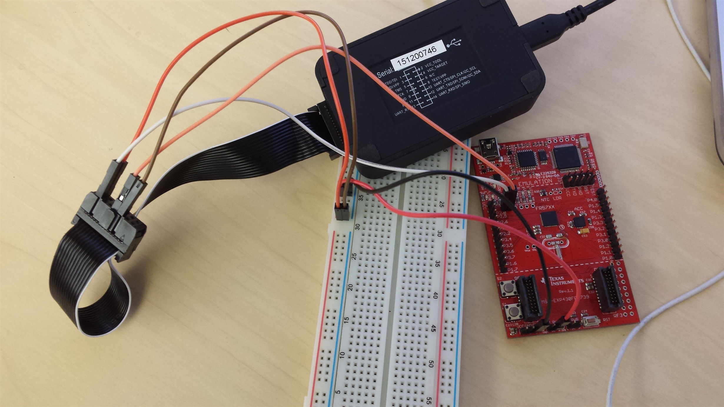

I recently purchased a MSP-FET tool to program the MSP-EXP430FR5739 and measure power consumption. I have followed the MSP-FET user's guide to install the hardware in my machine and connected the MSP-FET to the experimenter board as follows (see also image):
MSP-FET MSP-EXP430FR5739
TDD/TDI (Pin 1) RST/NMI/SBWTDIO (Pin 20 --> TP15)
TCK (Pin 7) TEST/SBWTCK (Pin19 --> TP14)
VCC_TOOL (Pin 2) MSP_PWR jumper pin
GND (Pin 9) GND jumper pin
Please notice that I have disconnected the eZ-430 programmer/debugger (J3 jumpers).

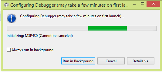

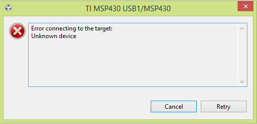

The problem is that, when pressing the debug button, CCS configures the debugger (figure 2) and then it shows the following error message (figure 3):
I suspected it was a problem with the wiring (as shown in the figure 1), so I checked all the connections and even tried a different configuration. Also, as suggested in some other link, I externally powered the experimenter board (3.3 V DC), and at least I could see how the board started working (as expected), as this wasn't happening just connecting the board to MSP-FET.

  • Hi David,
    Your JTAG connections seem completely flipped based on the picture you provided. The while cable line and small arrow on the JTAG connector indicate where pin 1 is located. I apologize for the confusion caused by the image on the MSP-FET, it represents the connections as viewed from the top of the JTAG connector instead of the bottom like you expected.
    Ryan
  • Hi Ryan,
    So simple and I didn't realise that minor detail... It now works. Many thanks.
