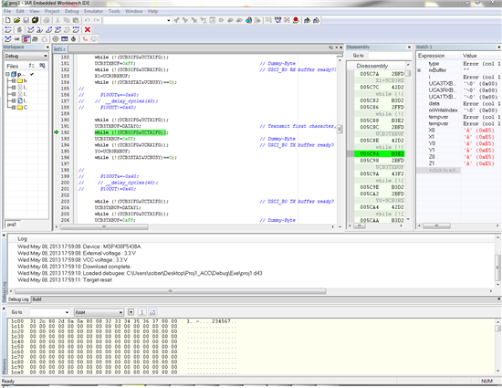

I am a newbie to MSP430 and SPI protocol. I read a lot about SPI online and also in the User Guide of MCU. The problem I am facing is described below;
I am interfacing ADXL345 Accelerometer with MSP430F2274 via  3 wire SPI. I think I am doing all the initializing correctly, but I am not getting any useful data back.
I am trying to read the device ID of ADXL345 but I keep on getting 0xF2 instead of 0xE5.
This is the data sheet for ADXL345; http://www.analog.com/static/imported-files/data_sheets/ADXL345.pdf
ADXL345 takes 16 bits of data at one time but the MCU can only clock out 8 bits in one transmission, I think this creates a timing difference in the communication and hence
I don’t get what I want. Below is the code I am trying to use:

  • Just now I successfully  read the Device Id.
    So what you expect is
    11100101
    and what you get is
    11110010
    Looks like you're getting a superfluous '1' as the first bit and miss the last. This may be caused by a wrong clock edge setting. Or because the time between setting the chip select low and clocking the first byte is too short, so the first clock pulse is ignored.
    Satbir Sekhon said:
       for(i = 0xFFFF; i > 0; i--);                                                             // Delay
    This is no delay. This is dead code and (hopefully) optimized away by the compiler.
    All it does is setting i to 0. Making it volatile most likely won't help here.
    For delays of any sort, either use a timer (this is the exact way and behaves identically even on differently clocked systems) or use the __delay_cycles() intrinsic, which will change the outcome depending on the current MCLK frequency, but at least won't be optimized. And as the very last option, add a __no_operation() into the for loop. This will force the compiler to not consider the loop as dead code. It might, however, partially unroll the loop, so the delay time might change depending on the compiler type and revision and optimization level.
    Also, don't deselect CS before the last byte has been received. The slave might immediately stop sending and you'll get only half of the last byte. If TXBUF is empty, this does NOT mean that the transmission is complete. It rather means that the last byte has started being sent. Only after RXIFG has been flagged, you can be almost sure that the transmission is complete (at least the reception of the byte). To be entirely sure that even the sending is complete and the slave has got the last bit, check the UCBUSY bit. It is set until the last bit has been really sent and the SPI hardware is in idle state.
    use TXIFG only if you want to know whether the next byte may be put into TXBUF, and nonly if you either read teh RX byte from the last transfer (so rather wait for RXIFG) or don't care for the incoming byte(s). If an ISR kicks in after you put something into TXBUF but before you read RXBUF, you might lose the received byte. TXIFG is always one byte ahead of RXIFG.

  • I tried your suggested method, but still no luck.
    I checked the UCBUSY bit as     #define wait_tm() while (UCBUSY==0)         // Transmission Done?, while debugging i didnt see this bit changing, may be it changes so fast that i am unable to see it. I was trying to use the following read function:
    char read_byte(char byte)
        IFG2 &= ~UCA0RXIFG;
        UCA0TXBUF = byte;                      // Adress to be read
        wait_tx();                               // TXBUF ready?
        UCA0TXBUF = 0xff;                     // Dummy write
        wait_tm();
        return UCA0RXBUF;
    by calling it as;
    spi_on;
    devid = read_byte(0x80);
    spi_off;
    It only works if i reset the target board using IAR.
    It will be very helpful if you can  provide me a good example of spi read, write and wait functions.
  • Your read_byte funciton is still faulty.
    What you want is to send a command to the slave, then get its response, right?
    But what do you do?
    You clear RXIFG, fine. You could as well make a dummy read from RXBUF, but either way you're discarding anything in the RC buffer.
    BUT now you're assuming that nothing else is still in the receiving process. It's quite possible that there's still a byte in transfer and you'd end up with a superfluous byte.
    If this is the only function ever used, this is no problem, as you wait at the end for all transfers finished. And after all, you are the master. But it might decrease maximum throughput if you want to send or receive larger portions of data in a row. Anyway, just let's make this thing work and let the rest for later :)
    Now you're putting teh command byte into TXBUF. Since the SPI is (assumedly) idle, this byte is moved into the shift register immediately and TXIFG is set immediately again.
    wait_tx()  does not wait asn TXIFG is already set again.
    Now you put a dummy byte into TXBUF to request your response byte.
    At this point, the (dummy) response to the command byte hasn't been received as the command byte is still being sent. Normally, this wouldn't be a problem.
    Then you wait for the SPI being idle.
    If the SPI is idle, this means, that the command byte has been sent (and the dummy byte was received), then the dummy byte was sent and the response byte received. You received two bytes, yet you didn't read the first causing a buffer overflow. If you ignore it (at least bad style to write code that causes errors by default), things would be still fine, IF your wait_tm would do what it is intended to.
    Unfortunately it doesn't:
    What happens is that while the command byte still hasn't been sent, you wait as long as UCBUSY==0. Unfortunately, UCBUSY is a bit value constant and always !=0. So you don't wait at all.
    So you grab the content of RXBUF while (depending on MCU speed and SPI speed) the dummy byte or maybe both bytes haven't been sent yet.
    If the timings are close, it might happen that after a reset, when teh SPI is really idle, the command byte is being sent immediately when you write into TXBUF. But since you exit the funciton before all is sent, on the next run the SPI isn't idle anymore and it takes longer to send the command and the dummy byte.
    Then you deselect the slave while the SPI is still busy and at the end all is messed-up.
    The correct definition of the wait_TM macro would be:
    #define wait_tm() while(UCA0STAT&UCBUSY)
    And note that when the SPI is BUSY, the bit is SET. Other than the IFG flags, the UCBUSY bit is cleared when the SPI is done. (else it would be an UCIDLE bit :) )
  • Thanks for being patient here.
    Yes, you are right, I am sending the command which is the address to be read and the bit which tells that it is a read operation.
    Now I think my read function is working good, as it is giving me expected results every time. It is as shown below;

  • Hi!
    The Code is compiled now, but the content of the RXBUF is always 0x00. My goal is to receive the information of the x-, y- and z-axes in
    a stream mode. Is mybe the configuration of the sensor wrong?

    I forgot to add the code to my comment. I tried to read the ID and I set a Breakpoint. Most of the times I ran the program it worked ok, but sometimes not.
    Could the Delay be a problem? I Tried it with __delay_cycles(5).  I have putted a configuration method in the code. Is the method ok like this?
    Later (if the testread-function is ok I want to replace it by reading the value of the coordinates( at the bottom of the code there is a commented example for X0).
    Could it work out like this? Advices?
    Greetings

    Thanks for the comments and help! I changed parts of the code and now I am receiving 0xC7 instead of the right ID. Also in the first run I can just see 0x00 in the variable.
    I removed the interrupt stuff. Thanks.
    What is the differenz between UCB3CTL1|=UCSSEL_2;and UCB3CTL1|=UCSSEL_3;  ? Both refer to the SMCLK.
    Greetings!

    Now I want to configure the registers in the right way to receive the data of the axes.
    #include "msp430x54xA.h"
    #include "hal_MSP-EXP430F5438.h"
    #include "hal_lcd.h"
    #include <stdint.h>
    #include "hal_pmm.h"
    #define SYSTEM_CLOCK    23986176
    #define USB_PORT_OUT      P5OUT
    #define USB_PORT_SEL      P5SEL
    #define USB_PORT_DIR      P5DIR
    #define USB_PORT_REN      P5REN
    #define USB_PIN_TXD       BIT6
    #define USB_PIN_RXD       BIT7
    #define USB_PORT_BAUDRATE            57600
    #define UART_A3_PSEL                P10SEL
    #define UART_A3_PDIR                P10DIR
    #define UART_A3_TXD_MASK            BIT4
    #define UART_A3_RXD_MASK            BIT5
    #define UART_A3_BAUDRATE            57600
    char rxBuffer[256];     //Buffer to keep received messages/responses/events from module
    char rxReadIndex = 0;
    char rxWriteIndex = 0;
    volatile char dataReady = 0;    //variable to declare is message is completely received (to be implemented)
    volatile unsigned int i; // volatile to prevent optimization
    unsigned int SetVCore (unsigned char level);
    void initSystemClock();
    //unsigned char contrast   = 0x66;
    //unsigned char backlight  = 8;
    void lcdStart();
    void portsInit();
    /************************************** MAIN *****************************************/
    /********************** sends command and keeps idle - stop **************************/
    /********************** debugging and check memory contents **************************/
    /********************** rxBuffer[] should contain response  **************************/
        unsigned char MST_Data = 0x80;                          // Initialize data values
        unsigned char MST_Data2 = 0xFF;
        unsigned char SLV_Data = 0xE5;                          // Slave-Data, Roko
        unsigned char tempvar;
        int j = 0;
      // SPI-Configurationfunction
         void spi_init ();
      // Code added by Roko
        uint8_t ADRESS_DATA_FORMAT=0x31;
        uint8_t ADRESS_BW_RATE=0x2C;
        uint8_t ADRESS_FIFO_CTL=0x80;
        uint8_t ADRESS_POWER_CTRL=0x2D;
        uint8_t DATA_FORMAT=0x0A;                            // 100 Hz output rate
        uint8_t BW_RATE=0x0A;                                //
        uint8_t FIFO_CTL=0x80;                               //
        uint8_t POWER_CTRL=0x08;                             //
     // Variables for measurement
        uint8_t DATAX0=0x32;                                 // adress
        uint8_t DATAX1=0x33;                                 // adress
        uint8_t DATAY0=0x34;                                 // adress
        uint8_t DATAY1=0x35;                                 // adress
        uint8_t DATAZ0=0x36;                                 // adress
        uint8_t DATAZ1=0x37;                                 // adress
     // Results measurements
        uint8_t X0;
        uint8_t X1;
        uint8_t Y0;
        uint8_t Y1;
        uint8_t Z0;
        uint8_t Z1;
    void main(void)
        WDTCTL = WDTPW + WDTHOLD; // Stop watchdog timer
        //initSystemClock();
        // It's 4 wires, but in reality 3-wire mode for MSP430, since the CS is manually controlled. Still full duplex (and not half)
        P10DIR |= 0x40; // CS pin.
        P10SEL |= 0x0E; // or BIT1 + BIT2 + BIT3;
        UCB3CTL1 |= UCSWRST;                                          // **Put state machine in reset** !!!
        UCB3CTL0 |= UCMST + UCSYNC + UCCKPL + UCMSB;// + UCCKPH;      // 3-pin, 8-bit SPI master
        //UCB3CTL1 |= UCSSEL_1;                                       //   ACLK = ~32.768kHz,
        UCB3CTL1 |= UCSSEL_2;                                         // SMCLK
        //UCB3BR0 = 0;                                                //
        UCB3BR0 = 0x02;                                               //
        UCB3BR1 = 0;                                                  //
        UCB3CTL1 &= ~UCSWRST;                                         // **Initialize USCI state machine**
        UCB3IE |= UCRXIE;                                             // Enable USCI_B3 RX interrupt
        P10OUT |= 0x40;                                               //set high (CS active low)
        __delay_cycles(100);                                          // Wait for slave to initialize
         //******* ROUTINE TO SEND   //TEST_ID
    //    P10OUT &= ~0x40; //select slave
    //    while (!(UCB3IFG&UCTXIFG));                                 // USCI_B0 TX buffer ready?
    //      UCB3TXBUF = MST_Data;                                     // Transmit first character
        spi_init();
        __bis_SR_register(GIE);                                       //  enable global interrupts
        while(1)
    #pragma vector=USCI_B3_VECTOR
    __interrupt void USCI_B3_ISR(void)
      switch(__even_in_range(UCB3IV,12))
        case 0: break;                                                  // Vector 0 - no interrupt
        case 2:                                                         // Vector 2 - RXIFG

    Every axes receive the same data in the moment. I am working on that.
     Line 179     while (!(UCB3STAT&UCBUSY)==0);
      Line 181    while (!(UCB3IFG&UCTXIFG));
    Maybe this is unnecessary.  Can you give me advices for the measurement section in the interupt vector? I am trying to put CS low and high after every measurement
    to get reasonable .
    Greetings
          UCB3TXBUF=0xFF;                                             // Dummy-Byte
          while (!(UCB3IFG&UCRXIFG));                                 // USCI_B0 TX buffer ready?
          Y0=UCB3RXBUF;
          buffer[2]=Y0;                                               // Putting Data from Variable Y0 into the buffer
    //      P10OUT&=~0x40;
    //     // __delay_cycles(40);
    //      P10OUT|=0x40;
          UCB3TXBUF=DATAY1;
          while (!(UCB3IFG&UCRXIFG));                                 // USCI_B0 RX buffer ready?
          Y1=UCB3RXBUF;
          buffer[3]=Y1;                                               // Putting Data from Variable Y1 into the buffer
          // Transmit first character, Address(ROKO)
    //      P10OUT&=~0x40;
    //      P10OUT|=0x40;
          UCB3TXBUF=DATAZ0;                                           // Transmit first character, Address(ROKO)
          Z0=UCB3RXBUF;
          buffer[4]=Z0;                                               // Putting Data from Variable Z0 into the buffer
    //      P10OUT|=0x40;
    //      P10OUT&=~0x40;
          UCB3TXBUF=DATAZ1;                                            // Transmit first character, Address(ROKO)
          Z1=UCB3RXBUF;
          buffer[5]=Z1;                                                // Putting Data from Variable Z1 into the buffer
          P10OUT|=0x40;
    //        while (!(UCB3IFG&UCTXIFG));                         // USCI_A0 TX buffer ready?
    //        tempvar = UCB3RXBUF;
    //        if (tempvar == SLV_Data)                             // Test for correct character RX'd
    //          tempvar = 0xAA;                                    //tempvar=0xAA;
    //        else
    //          UCB3TXBUF = MST_Data2;                             // Send next value  (Roko, sending Dummy byte)
    //      j++;                                                   // Zeile zum Debuggen
        // sending the adress to start conversation with POWER_CTL
          UCB3TXBUF=ADRESS_POWER_CTRL;                          // Transmit first character, Address(ROKO)
          P10OUT|=0x40;
          __delay_cycles(40);
        // sending 0x08 to the POWER_CTL Register to start the measurement
          P10OUT&=~0x40;
          UCB3TXBUF=POWER_CTRLstop;                                 // Transmit first character, Address(ROKO)
          P10OUT|=0x40;
          __delay_cycles(40);                                   // Add time between transmissions to
                                                                // make sure slave can process information  (seems to avoid putting CS to high)
    //      if(j==2)
    //        tempvar++;
          break;
        case 4: break;                                          // Vector 4 - TXIFG
        default: break;
