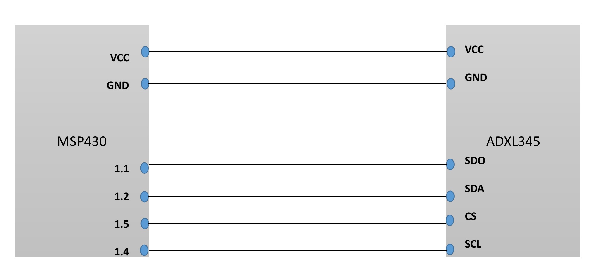

Hello everyone,
I am a newbie to MSP430 and SPI protocol. I read a lot about SPI online and also in the User Guide of MCU. The problem I am facing is described below;
I am interfacing ADXL345 Accelerometer with MSP430F2274 via  3 wire SPI. I think I am doing all the initializing correctly, but I am not getting any useful data back.
I am trying to read the device ID of ADXL345 but I keep on getting 0xF2 instead of 0xE5.
This is the data sheet for ADXL345; http://www.analog.com/static/imported-files/data_sheets/ADXL345.pdf
ADXL345 takes 16 bits of data at one time but the MCU can only clock out 8 bits in one transmission, I think this creates a timing difference in the communication and hence
I don’t get what I want. Below is the code I am trying to use:

  • Mr. Gross
    I am always thankful for your replies!
    I tested this piece of code for reading the ADXL ID and it works fine.
    Kindly see the code below. You can see that I am using while(1) to keep reading the 1st byte of x acceleration (register 0x32, to be read as 0xB2). But I am getting the same value 0xF9? even if I move the acceleromter and re load the code , I am still getting 0xF9. Would you please take a look and advice if I am doing something wrong.
    And for reading 6 bytes, now I know that I should set the B bit, but how can I specify that I want to read 6 bytes starting from 0xB2? should I use a function that takes care of sending a string of bytes?

  • >while (!(IFG2&UCA0TXIFG)); // Wait for TXBUF ready
    >UCA0TXBUF = 0xB2; // Read the acc X0 register (0x32)
    >while(!(IFG2 & UCA0RXIFG)); // Wait for RXBUF ready
    >ACC_X0 = UCA0RXBUF;
    >UCA0TXBUF = 0xFF; // Send dummy byte
    The ACC_X0 data comes back in the following byte (see Figure 38). That is, it's available only at the end of this sequence, after sending the dummy byte.
    More generally: To follow this pattern, you should make a point of always reading UCA0RXBUF after waiting for UCA0RXIFG, or you'll be off-by-one later. If you're not interested in the contents, you can do something like "(void)UCA0RXBUF;" to make it clear you're reading it and throwing it away. I usually wrap this sequence (wait-write-wait-read) into a separate function so I don't forget.
  • Bruce already said it, but maybe not detailed enough to really understand the mistake here.
    Let's write down what happens when, starting with a freshly initialized USCI module.
    At this point, UCA0TXIFG is set, as it is instantly set as soon as the USCI is initialized and UCSWRST is cleared.
    This clears UCA0TXIFG. with the next clock pulse, 0x2D is moved to the output shift register and UCA0TXIFG is set again, indicating that UCA0TXBUF can take a second byte now (which will sit there until the previous one is done sending). This double-buffering enables higher throughput on high SPI clock rates.
    While  the 0xb2 is being sent, the USCI will at the same time receive 8 bits. If the slave doesn't send anything, the USCI will receive 0xff. Or whatever signal level the MISO line will have. The slave can't send the register content right now, as it hasn't received the read request (it is still sending). Once UCA0RXIFG is set, the USCI received a DUMMY byte.
    > ACC_X0 = UCA0RXBUF;
    You read the dummy byte, not the ACC-X0 value here. You have to read UCA0RXBUF or at least manually clear UCA0RXIFG here, so you can see when the next byte is received, the one you want.
    You can make a dummy read by simply writing
    UCA0RXBUF;
    Since this is a volatile memory location, teh compiler will generate a read access (which is what you want) even if you do not do anything with the read value.
    Well, since the USCI was idle at start, TXIFG is already set here. But waiting won't hurt
    This starts sending a dummy byte and at the same time starts receiving the requested data byte.
    Here you wait for the data byte being received. That's okay. But after this line, you should read the data byte:
    ACC_X0=UCA0RXBUF; // this time, we get the ACC vlaue, not the dummy byte.
    Then you wait for UCBUSY clear before you de-assert CS. Since you already got what you want (the byte was received), the wait is not 100% necessary. However, it is a good habit, as it deals with all situations and software protocol variants. Sometimes, a transfer from (and more often: to) a slave has side-effects if CS is de-asserted too fast. Even if you already got what you want, the slave might consider the transfer incomplete and skip incrementing a counter or updating a register as intended. Or even discard the received byte instead of writing it. Sometimes, an additional delay even after completing the transfer is required (especially on write access to non-volatile registers or flash cells).
    However, after UCBUSY is clear, UCA0TXIFG is set, as a clear UCBUSy implies that both, UCA0TXBUF and the output shift register are both empty.
    The above sequence also applies to reading the ID register 0.
    For writing to a register, you always get dummy bytes for ever byte you send, but you probably won't care. However, ensure that you clear UCA0RXIFG after the transfer is competed (or before you start a new read operation).
    For reading all ACC registers in a block, send 0xf2 as register address, then send another dummy byte for each additional register and you'll get another data byte. If you always wait for the IFG bits being set, you won't have problems. But this is slower than necessary. You either have a (physical) transfer or handle the data/prepare the next byte. Instead of handling the data while the next transfer is already in progress.  When you want fastest throughput or when you move to interrupt-driven operation, you'll get/handle the interrupts when and in the order they happen and not when you check for them. Then you'll have to take care of the interleaved operation (one byte waiting in TXBUF while the previous one is being sent and/received, receiving a byte in RXBUF in response of the penultimate byte you wrote to TXBUF)

  • Sorry guys, I am bothering you with my e-mails. But I did not got it to work. Now I am getting 0x3C  for ACC_X0, even when I pause the program and run it again. i.e. the value does not change, even if I change the orientation.
    The code is as shown below. I also attach the connection diagram to take a look at for a double check .
    Many thanks

  • In your graphic, I noticed the label 'SDA' on the ADXL side. It should actually read SDI (serial data in) and matches the MSP's SIMO pin while SDO matches SOMI. YOur wiring is correct.
    It should be nothed that '3-wire-SPI' refers to different things on the ADXL and MSP. On ADXL it means you have clock, one data line and a chip select (the MSP doesn't support this), while the MSP doesn't count the chip select (every slave has its own , so only the shared lines on the bus are counted). MSP's 3-wire mode matches what ADXL calls 4-wire mode.
    The code looks good too, regarding the general SPI operation. One thing I noticed: when initializing P1DIR.5, the content of P1OUT is undefined. So the pin may switch to high or low. Furthermore, before this, the pin is high-impedance, which is an undefined state on the ADXL. It may be that the ADXL is selected from this moment on.
    To be on the safe side, you should set P1OUT.5 to 0, P1DIR.5 to 1 and then P1OUT.5 to 1. This gives the CS line a defined state and terminates any assumed (bogus) transfer.
    The clock speed is quite low (128kHz on 16MHz SMCLK). The ADXL can cope with 5MHz. But that's no problem, as long as you only use the 200Hz output data rate and below (default is 100Hz, so this is okay). For the higher output rates, you'll need a higher SPI clock.
    Why do you send 0x10 ot the power register? This enables auto-sleep, which you likely doN't want at this time and which may have side-effects depending on other config settings (I didn't check the defaults). You may/should skip this step.
    Default is +-2g range, so teh values read must be clipped (whatever this means, I did read this in the register 0x31 description)
    But the main problem is:
    It takes some time after enabling measure mode to get the first valid result. On 100Hz output rate, I would assume 10ms before the first result is ready. 10ms on 128kHz SPi clock means it takes the time to transfer 160 bytes on SPI before the first sample is ready.
    But you instantly read the data. And on each program loop, you exit and re-enter measure mdoe, so the 10ms delay starts again on each loop. This way, there will never be a measure cycle completed and the registers will never get any value apart from the power-von content.
    You may add a delay funciton that continually reads register 0x30 (using address 0x70 followed by a loop of dummy writes) until the returned byte (except for the first, which is the dummy response) has the MSB set (DATA_READY). This busy-waiting loop would delay the progress of the code until data has been measured. The DATA_READY-bit is cleared when you read the register, whether you actually read the data or not. So when it is set next time, the next set of data is available.
