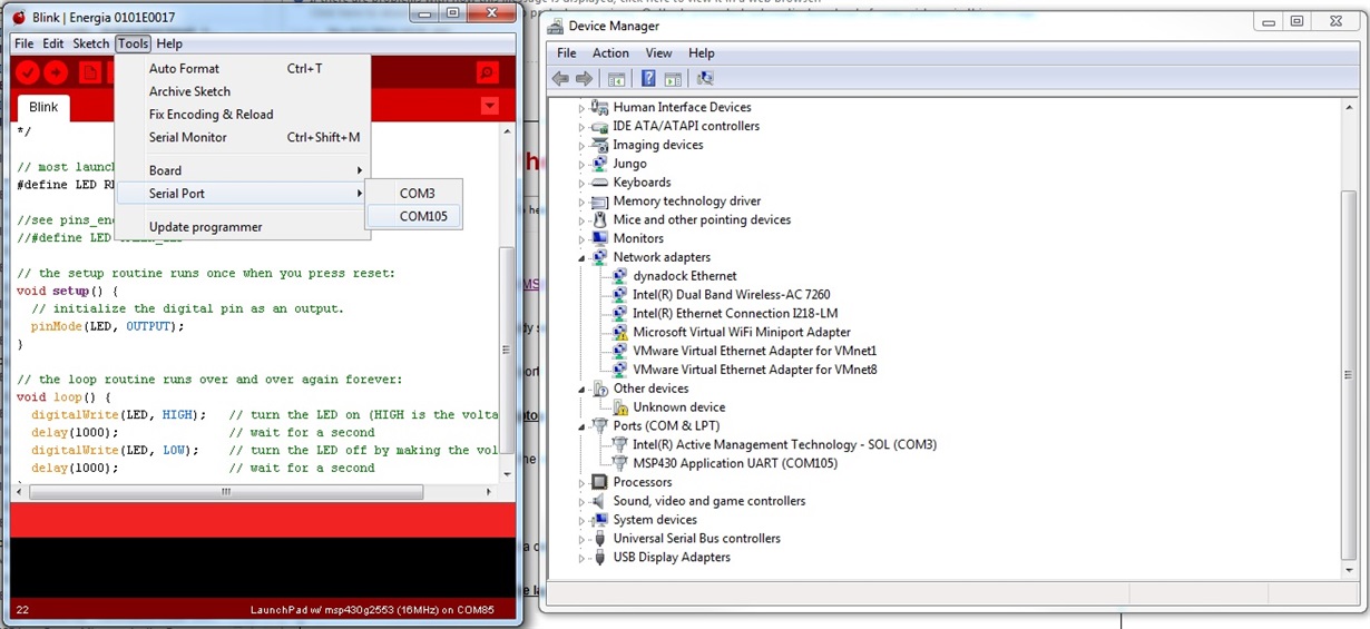

  • Does your Device Manager appear as such?
    If not then you might need to manually install the MSP-EXP430G2 driver: http://www.ti.com/lit/zip/slac524
    Does the issue exist in earlier versions of Energia?  I'm not having issues with E17.
    Regards, Ryan
  • yes it appear in device manager.
    but i notice that in my Energia on the right corner it doesn't appear as in your pic. maybe my energia doesn't recognises it as a launchpad ?
