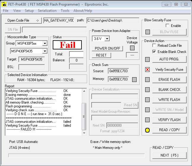

    I connected it to a MSP430 USB-Debug-Interface MSP-FET430UIF to view the secure fuse in their GUI.  You can see the first program went through fine because it hasn't been programmed with our custom GUI with new DLLs and new programmer.  But when in I put in the device that is non-responsive, aka the one that fails at initialization, I get this.

    If your program (during execution) on MSP430F5435 doesn't write anything to protected BSL flash memory segment where soft JTAG fuse value is located, than this is due to bad code.
  • Hi Matt,
    Do you know what addresses your program writes to in the device? Does it write to the BSL area of flash?
    In addition, it could just be a bad code load - in that case, the best way to recover a failing part will likely be to use the BSL to erase the device - do you know if you have access to the BSL pins on this part? The default factory BSL uses the pins listed in the datasheet www.ti.com/.../msp430f5435 table 6-3 BSL Pin Requirements and Functions - do you have access to these pins on your device? If so I could walk you through connecting the MSP-GANG or MSP-FET (not MSP-FET430UIF though) to erase the device using the BSL to see if you can then get back into the part.
    As for why this happens in the first place - it would be really helpful to know the sequence of commands called by your custom DLL project. Then we can check what it is doing.
    Katie
    BTW, I found that device locked due to bad code (fuse blow reported) can be unlocked (without BSL) by continuing SBW / JTAG forced execution, few times, until device become alive again. And I implemented this in my flasher. Of course this is related only to bad code, not to situation when fuse is really "blown".
