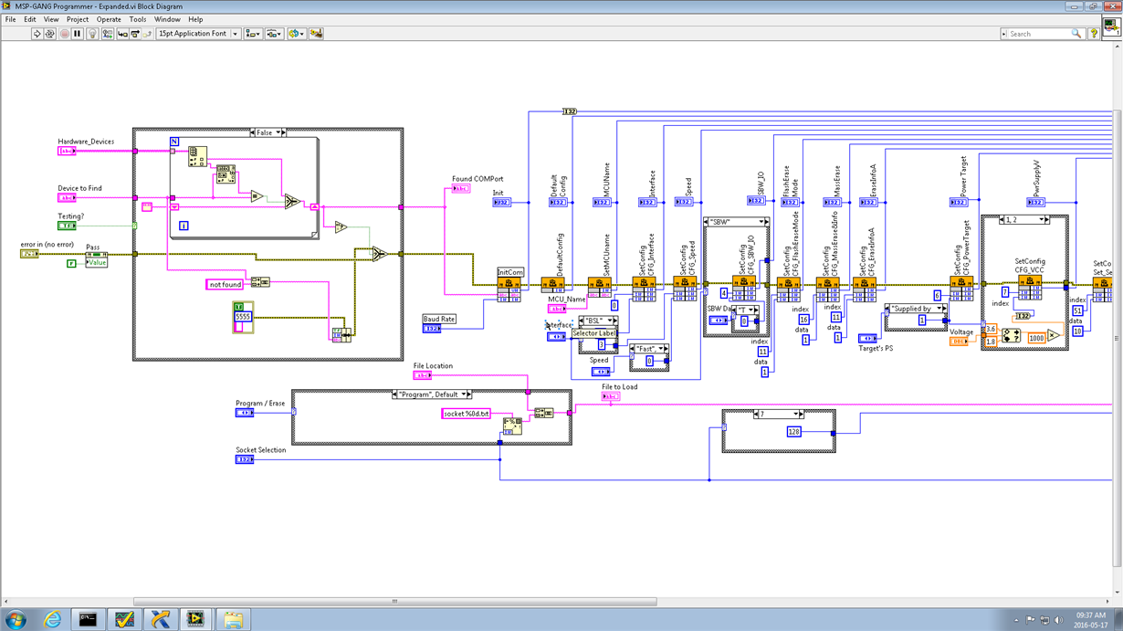

I am presently implementing a Labview use of the DLL to program MSP430's that we have.  This code has been utilized previously and worked successfully for JTAG (and still does).  What I found is that when I am using the SBW that once the programmer completes programming that it immediately starts to write the image to the same target again even though a new target is being passed into it.  I wasn't sure if there was another segment of the DLL that we needed to add in order for this to work properly?
I tried to upload the Labview source files, but this forum would not allow that.
