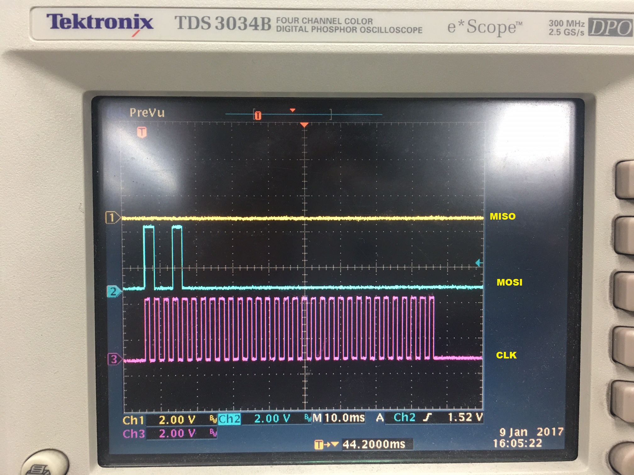

I have checked MOSI & Clock signal on Oscilloscope and getting perfectly.
but i am not able to read Manufacturer ID correctly on receiver buffer. Most of the time getting 0xFF, 0xFF or sometimes getting some random values.
Could anyone please help me figure out the issue.
Thanks & Regards,
John
  • Hi John,
    e2e.ti.com/.../563518
    Your MOSI & CLK oscilloscope screenshot did not attach properly, at any rate I'd like to see one with the MISO as well. You need to send some dummy values inside of the SerialFlash_RcvData function in order to generate the SPI CLK that allows the W25X10 to respond on the MISO line. Instead a 0xFF is interpreted since the line stays pulled up and unresponsive. Make sure that your SPI communication follows Figure 18 of the W25X10 datasheet, I've also noticed that the clock phase should be captured on the first edge (rising) and changed on the next (falling).
    Ryan

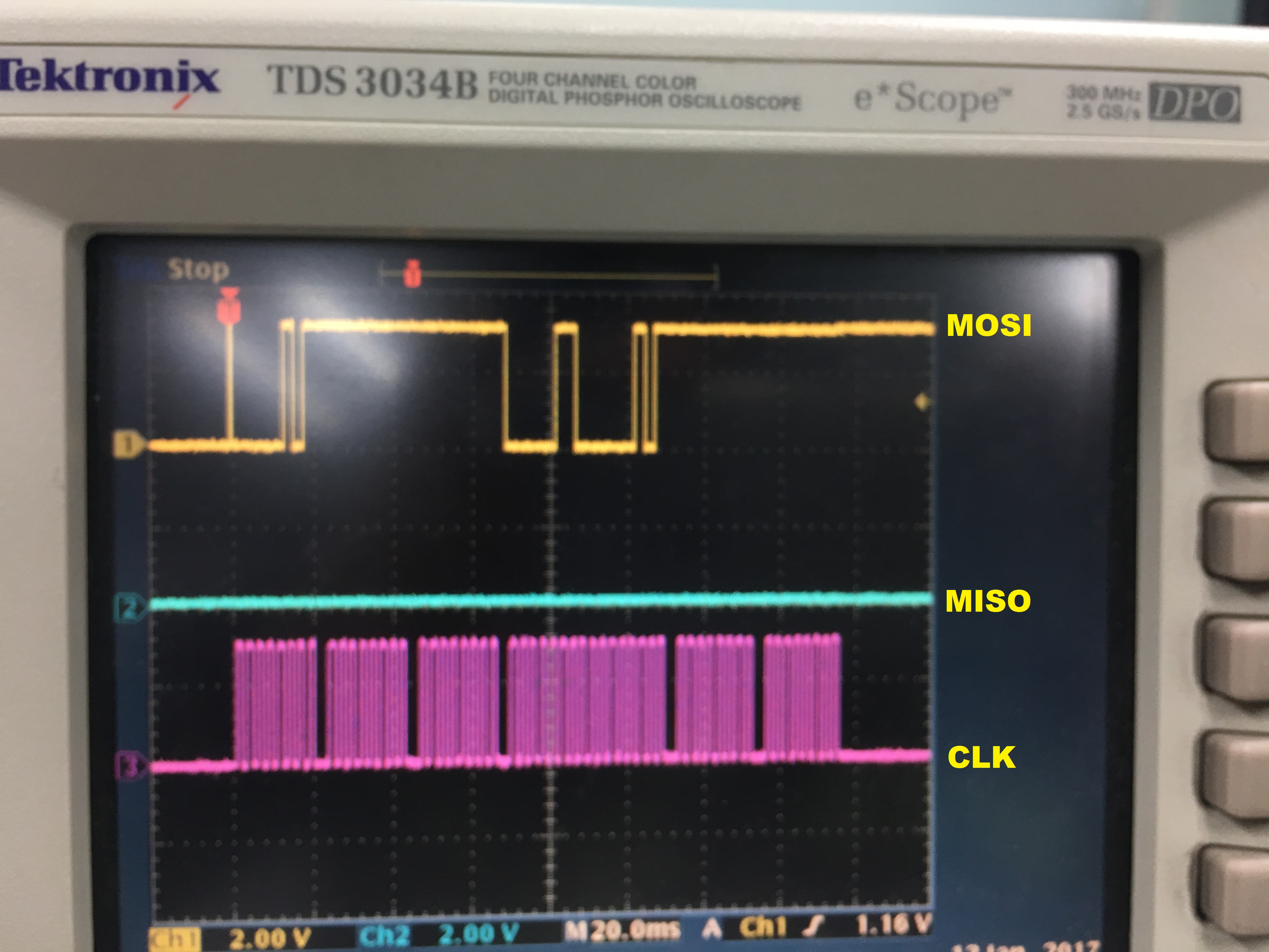

    Then trying to read 2 bytes Manufacturer ID but not getting anything.
    The Oscilloscope screenshot as below:
    Could you please help me to solve this.
    Thanks & Regards,
    John
  • It does not look like you have applied any of my previous suggestions, only four bytes are transmitted instead of six and the UCCKPH bit does not appear to be set.
    Ryan

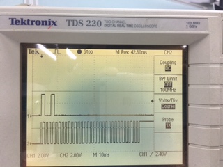

    Below is the Oscilloscope screenshot.
    what wrong i am doing that Enable bit is not setting?
    Thanks & Regards,
    John
  • You are trying to read the status register (05h), not the serial flash (03h), which is only one byte long (according to Section 10.2.2) and continues until CS releases it. Your next command is a write enable (06h) but do you even reset the CS pin before sending another status register read? You should view the enable bit as well to verify that it is being controlled properly.
    Ryan

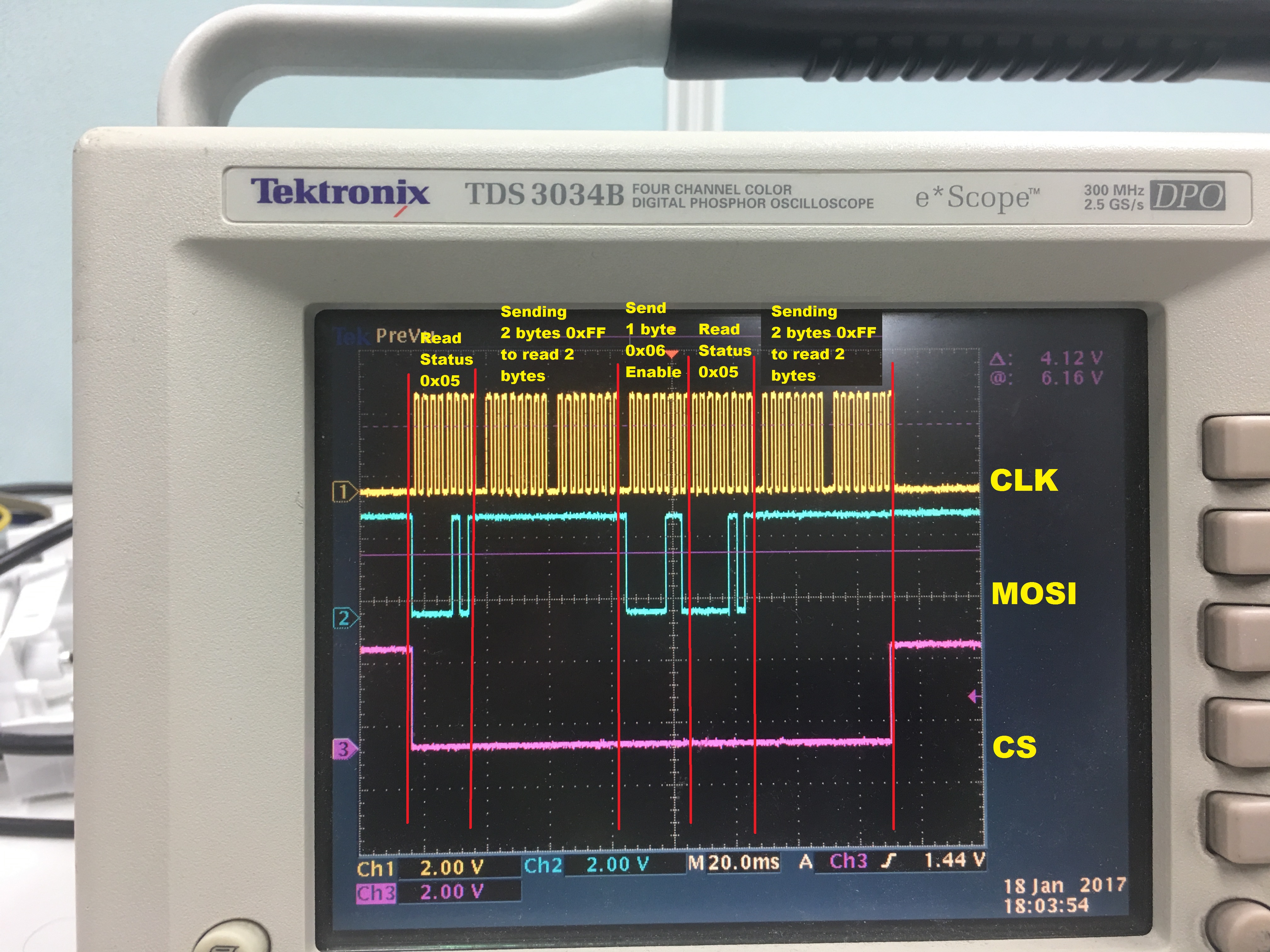

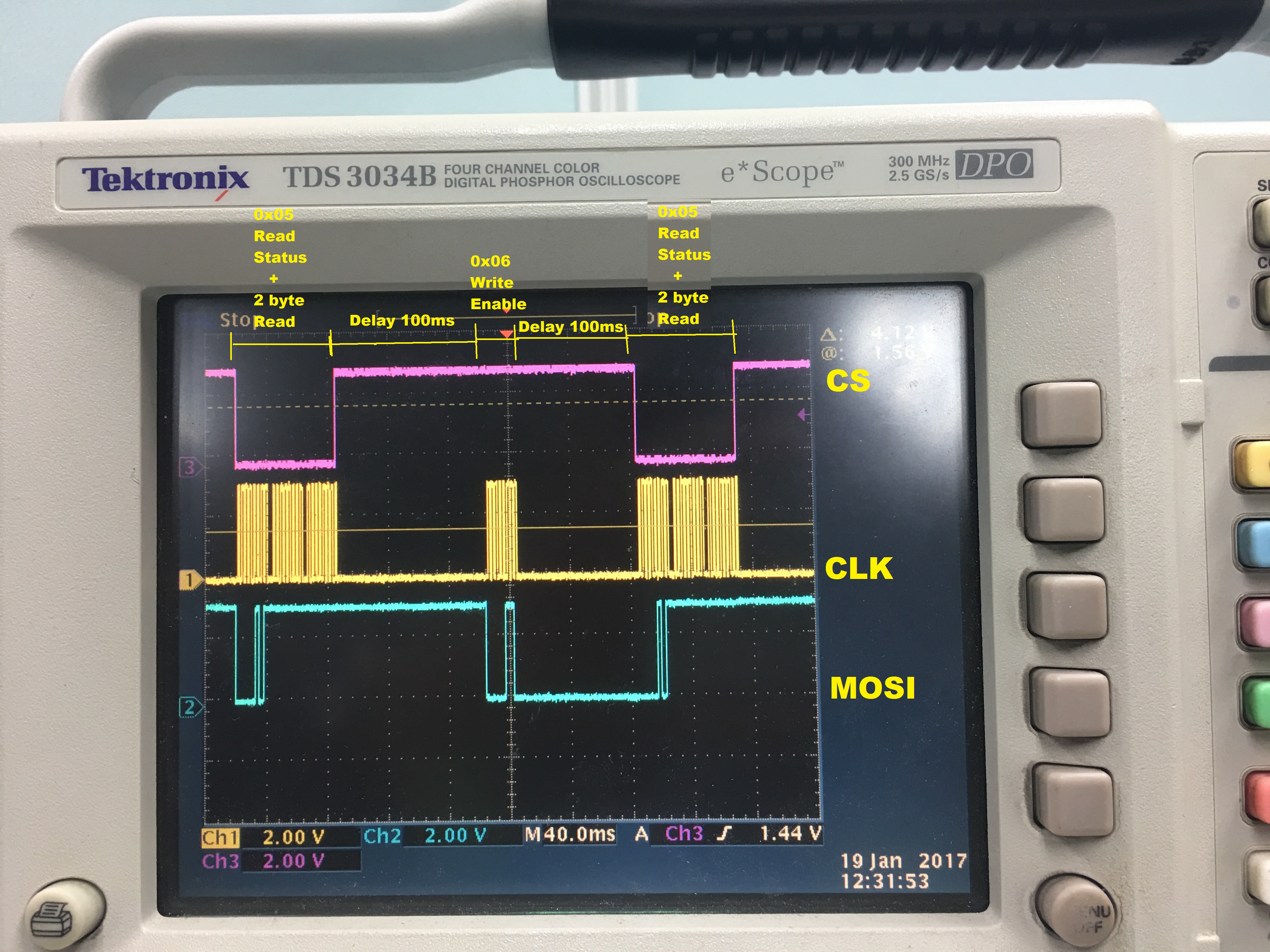

  • Hi Ryan,
    Below is the oscilloscope screenshot with CS.
    I am sending first 1) Read Status Command (0x05)
                                       2) Write Enable Command (0x06)
                                       3) Read Status Command (0x05) as below
    As you see my code above, for every command i select the CS and release it. But in oscilloscope not showing. Might be because of it's very fast.
    Could you please check what mistake i am doing?
    John
  • That CS pin needs to be toggling, either increase the sampling rate on your oscilloscope or add some delays to separate the commands. If the CS pin still fails to toggle then you know what the issue is and should address it accordingly.
    Ryan
  • Hi Ryan,
    I have checked CS pin by adding delay, The CS pin is toggling but when i am sending enable command it's not going to low as shown below.
    Really i am not getting why for Enable command it's not going to low.
    Do i need to send any extra byte or anything else for write command.
    Please help me to solve this issue.
    John
  • John,
    You're making good progress, now you just need to step through and debug your SerialFlash_WEnable function to find out how the CS pin is not being driven correctly.
    Ryan
