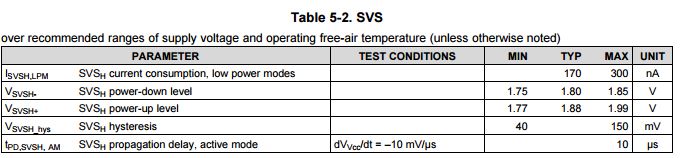

  • Hi James,
    Thank you very much for the inputs.
    I have one additional question:
    I'm reffering to MSP430FE599x datasheet:
    What about 1.8V power supply?
    I tried to apply 1.8V from the laboratory power supply, but MSP-EXP430FR5994 board doesn't work. It looks for me that board starts working when applied voltage is higher than 2.2V, which is indicative for me, together with the upper table.
    Stevan
  • Hi Stevan,
    As mentioned by Footnote 1 on the first page of the datasheet, the actual minimum supply voltage is restricted by SVS levels. The specific values are provided in Table 5-2 in the datasheet. The value of 1.8V is given, since it's in between the min and max values.
    Using the MSP-EXP430FR5994, I programmed the device with the 'msp430fr599x_lpm4-5_02.c' code example in CCS Resource Explorer. Then, after removing all the isolation jumpers that connect to the onboard emulator, I connected the LaunchPad to an external power supply via the "3V3" and "GND" pins. For this code example, the device is looking for a low-to-high signal on P1.3, which will trigger the LED to blink. I just used a jumper wire connected to the "3V3" pin and touched P1.3.
    First, I started at a supply voltage of 1.80V, but touching P1.3 didn't cause the LED to blink. After disconnecting from the power supply, slightly increasing the supply voltage, reconnecting, and repeating this process, I got the LED to blink at a supply voltage equal to 1.88V (keep in mind this was the value shown on the display and not measured from a multimeter). Looking at Table 5-2, 1.88V is the typical value where the Power Management Module (PMM) releases the BOR reset (as shown in Figure 2-3 in the User's Guide). On other devices, they could start operating at 1.77V or up to 1.99V.
    Hopefully, this makes sense.
