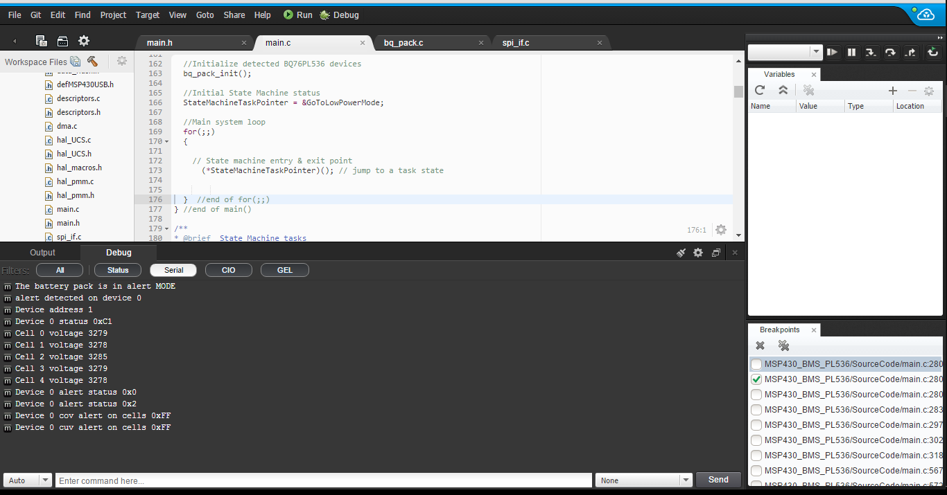

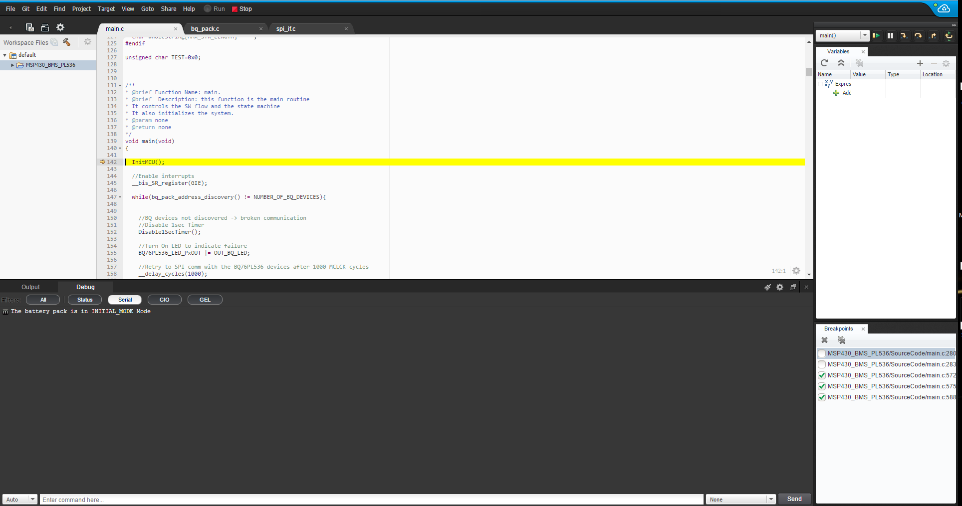

I am attempting to make a battery management system using the BQ76PL536EVM-3 and MSP-EXP430F5529LP, using the application report SLAA478.
So far, I've removed  resistors R49, R53 and R60 from the 'PL536, and I have modified the software available to use P1.5 instead of P1.1 (on the MSP430 LP) for the FAULT signal from the 'PL536.
However, when everything is connected, I am not seeing any data being sent to the host PC via USB (verified using PuTTY). In fact, using CCS, I am not seeing the any of the 3 bq76PL536 devices being assigned an address in the code.
What does happen, however, is that the red LED on the MSP430 LP (P1.1) switches on and stays on (implying a connection/communication problem between the MSP and BQ). Also, some cells connectd to the 'PL536 EVM seem to be discharging through their balancing resistors, even though their voltages are lower than the other cells in the pack.
Has anyone experienced this? Does anyone have a solution?

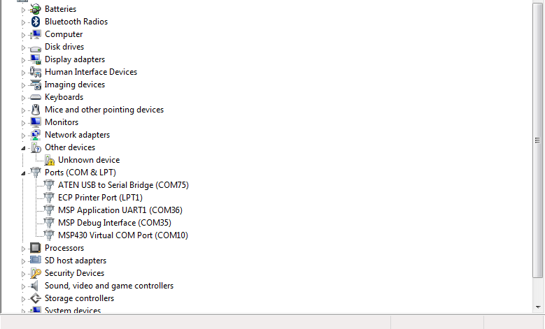

  • Hello James
    1) Yes, I have made the correct connections between the BQ76PL536EVM-3 and the MSP-EXP430F5529LP, as given in Section 1.1 of the applications. I have made all connections given in Table 1 and Table 2.
    2) I have tried using the original code, and the same thing happens. In this case, I am unable to make connections for the FAULT signal, since the code requires a connection to P1.1 on the MSP430, but this pin already has an LED connected to it on the LaunchPad. I thought re-assigning the FAULT signal to an unused pin (P1.5) would have solved the problem, but it didn't.

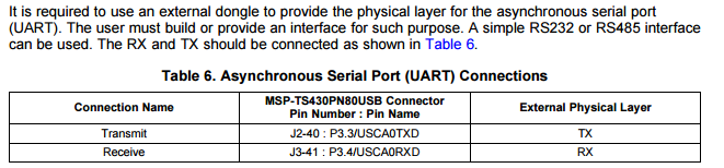

    3) The section of code in the 'main.h' file that Section 2.1.3 in SLAA478 refers to is the following:

    With a setup like this, should I not be able to use the USB A to microUSB cable to see the battery variables changing, or at least see some form of communication between the 2 devices? Or must I enable UART communications instead, then use a UART to RS232/USB cable to do this?
  • Thanks for checking the connections. Let's try using the backchannel UART on the MSP-EXP430F5529LP, which means commenting out the USB portions and uncommenting the UART portions in the 'main.h' file. Since you're using the LaunchPad, I'd change the original UART pins shown in Table 6 in SLAA478 to be the pins mentioned in Section 2.2.6 in the LaunchPad's User's Guide. You may also have to refer to the schematic or quick user's guide for the specific pin names. Keep in mind the proper RX -> TX and TX -> RX connections.
    Let me know if this allows you to communicate with the device.

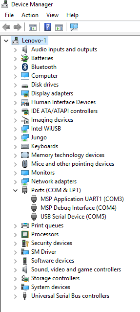

  • Hello James
    I tried your suggestion.
    Just commenting out the USB sections of code in ‘main.h’ and uncommenting the UART sections did not solve the problem. The same thing happens.
    When the program is running, suspending it consistently places the cursor within two functions: ‘spi_read_reg’ or ‘bq_pack_address_discovery’. These functions seem to be where the program is stuck/looping.

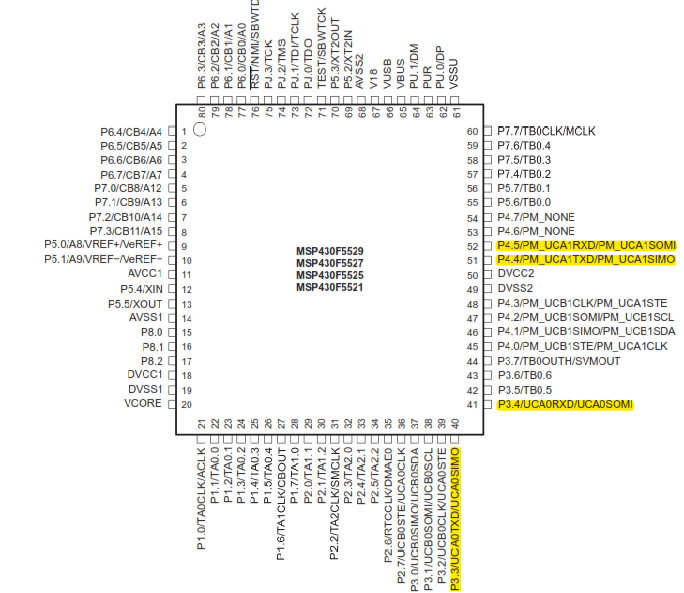

    For the second suggestion, the backchannel UART pins on the F5529 are pins P4.4 (TX) and P4.5 (RX).
    These are connected via jumpers to the ez-FET lite. Still, I made the changes from P3.3 and P3.4, to P4.4 and P4.5, respectively, in the ‘UART.h’ file. Still no change; the same thing happens. This is using the USB A to micro USB cable that came with the LaunchPad.
    Also, do these changes influence communications between the 'PL536 and LaunchPad? If I'm not mistaken, these devices use SPI to communicate, so any changes to UART should not affect the two.

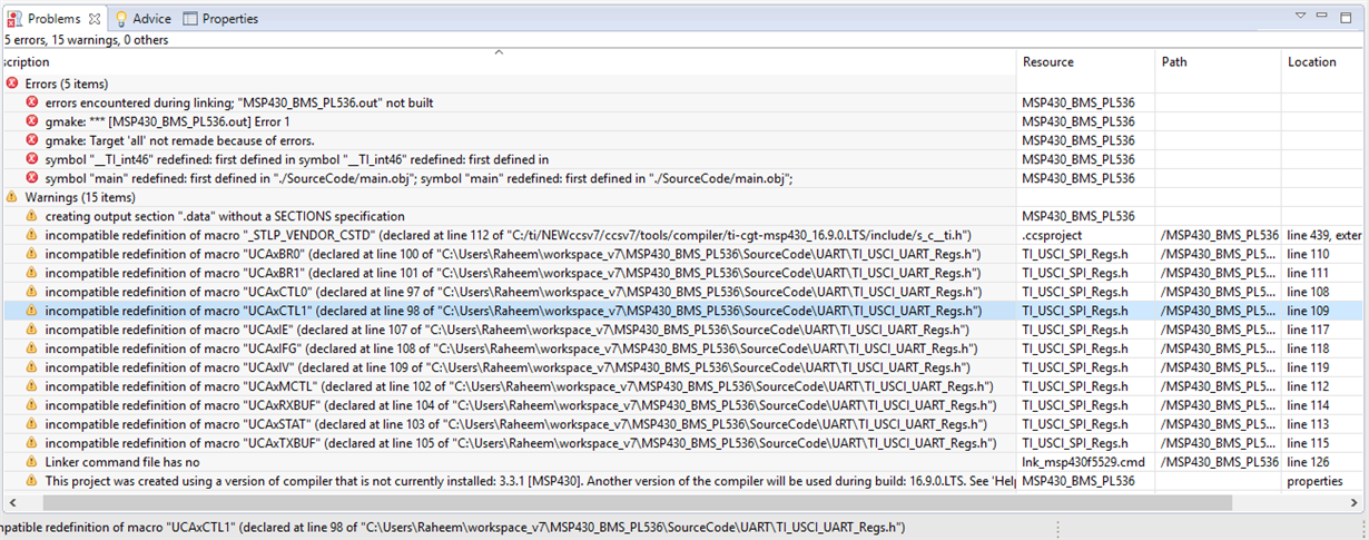

    There is an error in the file 'TI_USCI_SPI_Regs'. I am trying to find the exact lines that caused the error.
  • Let me know if you figure out what's causing the error. There shouldn't be a conflict between the UART and SPI interfaces, but maybe I'm missing something.

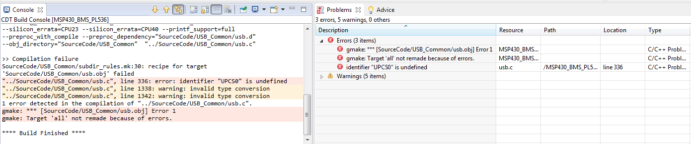

  • Hello James,
    I tried implementing this code, but it did not build. The errors were caused by the following lines:
    UCA1CTL1 |= UCSWRST; // **Put state machine in reset**
    UCA1CTL1 |= UCSSEL_2; // SMCLK
    UCA1BR0 = 9; // 1MHz 115200 (see User's Guide)
    UCA1BR1 = 0; // 1MHz 115200
    UCA1MCTL |= UCBRS_1 + UCBRF_0; // Modulation UCBRSx=1, UCBRFx=0
    UCA1CTL1 &= ~UCSWRST; // **Initialize USCI state machine**
    UCA1IE |= UCRXIE; // Enable USCI_A1 RX interrupt
    Apparently, those variables are not defined. Shouldn't those be in the msp430.h header file?

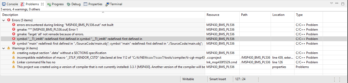

  • This is what appears when I try to build the original program ('main.c'):
    The first time when I tried building the program, and it failed, the file 'TI_USCI_SPI_Regs.h' has the mini yellow triangle next to it. Whenever I try building again to look for the errors, that triangle does not appear anymore.
    EDIT:
    Restarted the program, and the warnings appeared again:

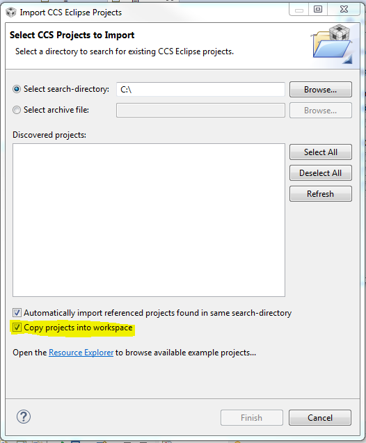

  • Hi Raheem,
    What version of CCS are you using? I'm asssuming (and also using) CCS v7. I downloaded the code and tried to build it, but I encountered an error pointing to 'usb.c'. Keep in mind I didn't make any changes to any other files. After removing "UPCS0 + " from Line 336, the code built without any errors. I found this solution in this thread.
    Next, I'll try to make the same changes as you to see if I can duplicate your errors.
    James
    MSP Customer Applications

    #define UART_PxOUT     P4OUT
    #define UART_PxDIR     P4DIR
    #define UART_PxIFG     P4IFG
    #define UART_PxIES     P4IES
    #define UART_PxIE      P4IE
    #define UART_PxSEL     P4SEL
    #define UART_PxREN     P4REN
    #define UART_RX_PAD    BIT5 // select uart pins P4.5
    #define UART_TX_PAD    BIT4 // select uart pins P4.4
    #include "TI_USCI_UART_Regs.h"

    I didn't encounter any errors after rebuilding. Perhaps you commented out too many lines of code in 'main.h'?
    James
  • Hello James
    I am using CCS v7. I could not find the source of the errors, and I had the same lines commented out in ‘main.h’ as you do.
    What I did instead, was remove all projects from the workspace, then re-installed CCS v7. This seems to have fixed the problem – there are no errors now when ‘main.c’ is built.
    I tried using the 'MSP430F55xx_uscia0_uart_01.c' code example, and this worked fine now, with no errors.

    Good job resolving those build errors! Maybe another project/workspace was affecting it somehow. In CCS, I generally keep a separate workspace for each project, and also when I import a project into CCS, I make sure to check the "Copy projects into workspace" option before finishing the import process. This way, it copies the original project into the workspace, so if necessary, you can delete the workspace without deleting the original project.

  • Hi Raheem,
    It sounds like you're making good progress. Regarding the driver, I didn't see the device popup in the bottom right when I had configured it for the UART communication, but after programming it for the USB communication, I halted debug and disconnected/reconnected the LaunchPad to my PC. A popup appeared on the bottom right, saying that the driver had not been installed. After going to Device Manager and finding the Virtual COM, I manually pointed the driver to the SLAA478 folder where the 'MSP430_CDC.inf' is located. I too got a warning about using the driver, but I just accepted that and completed the installation. Hopefully this helps clarify what I did.
    Let me know if anything is unclear.
    James

  • Hello James
    By switching back to USB CDC from UART, I assumed you meant enabling USB comms in 'main.h', and reverting back to previous UART settings in 'UART.h'. This is what I did. Next, I disconnected and reconnected the LaunchPad, but there was no pop-up asking for a driver. However, in Device Manager, this is what I am seeing:
    I assume that the presence of USB Serial Device (COM5) under Ports means that the driver is already installed. I have never been prompted for it, however, so perhaps it may have been automatically installed?
    Regarding the while() loop in 'main.c', I am unable to get past that loop. LED1 turns on, and the delay occurs, then the cycle repeats itself. I believe this may be sufficient indication that there is damage to the isolated communications interface on the EVM.
    Correct. I didn't change anything in 'UART.h', since changing the #define in 'main.h' to "USB_COMM" uses 'usb.h' instead.
    This is strange. Perhaps it's because I'm using Windows 7 and you're using Windows 8 or 10. When I changed back to USB_COMM and connected the LaunchPad, that's when the pop-up was displayed. After going to Device Manager, I found the USB CDC under "Other devices". Clicking on it and re-configuring the driver, the LaunchPad now shows up as Virtual COM port in Device Manager now. If you've configured your code for USB_COMM and reprogrammed the board and you're still seeing it as USB Serial Device (COM5), I'd try manually re-configuring that driver with the 'MSP430_CDC.inf' file.
    If you aren't able to get past the while() loop, it doesn't seem like the single device can be found over SPI, which is strange if the boards are connected properly. However, if the board is damaged, this would make sense. Hopefully you can obtain a working BQ EVM.

  • Hello James
    Using UART Communications, there was activity at the COM Port, verified using PuTTY. The only message that was sent from the MSP430 to the host PC was "The battery pack is in INITIAL_MODE Mode."
    Next, I decided to attempt create a GUI using GUI Composer V2 on the cloud, since I am using CCS v7. I uploaded the project to my CCS Cloud, then programmed the MSP430 from there. This time, after connecting to the COM port via CCS Cloud, I saw actual cell voltage data being sent to the host PC. But then, the system entered ALERT mode, and LED1 on the LaunchPad remained on. I ran the program again, and the same thing happened, except some cell voltage data were irregular, reading over 25V. I ran the program again, and then it put me pack to square one; the only message being transmitted was again, "The battery pack is in INITIAL_MODE Mode" :
    I stepped through the program to see what really happens. I found that it never gets to the UARTCommunicationTask() function (line 567 in 'main.c'). All that happens is it gets to the Timer1SecExpiredTask() function (line 277 in 'main.c'), and inside that function, there is another function, bq_pack_start_conv(). This function takes the program to 'spi_if.c' to a function spi_write_reg(), which runs 4 times. The program then returns to 'main.c', at the end of the main() function.
    Since UART communications were not working, I decided to revert back to USB communications. CCS Cloud was unable to open the terminal to the COM Port for the USB Serial Device, so I could not see if anything was actually being transmitted. Nevertheless, I stepped through the code to see what was happening.
    When the program got to the USBCommunicationTask() function (line 701 in 'main.c'), it entered the case ST_ENUM_ACTIVE in the switch case, then proceeded to the default action, which is nothing. The program then returned to the low power mode to await the next interrupt from the 1 second timer.
    Do you have any idea what may be causing these issues? I am still using the damaged EVM while I await delivery of the new EVM - is this likely to be the reason?
    EDIT:
    As I finished typing that, there was an update in the terminal. This is what I can see now:
    LED1 is still blinking though, implying that there is still communication, and the pack is not actually in alert mode. That update above has been the only one in about 15 minutes.
