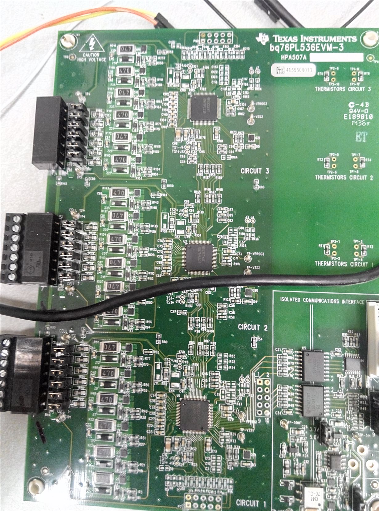

    Thank you for your continuous support, and sorry for the late reply. I am attaching the image of BQ76PL536EVM-3 (HPA507A). There are also other numbers if you want to see on the image, its probably the latest version and I bought it roughly a month ago directly from TI. I also found the schematics which I had attached previously, which do not show the resistors R49, R53 and R60.
    I am waiting for your final call on whether to remove the resistors or not, and will report the results of running a few USB examples.
