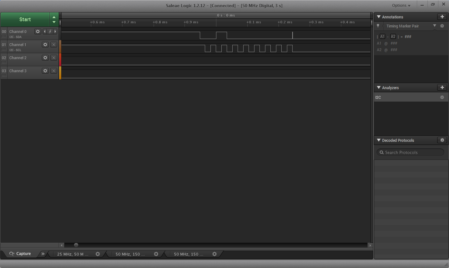

  • Oops, I forgot to include the logic analyzer screenshot, here it is: running at 100KHz, the I2C bus works exactly as expected and the MCP23018 is initialized to the correct state, however the ISRs were no help. I had to a while loop to not only to initialize the MCP, but to send and receive data from it.

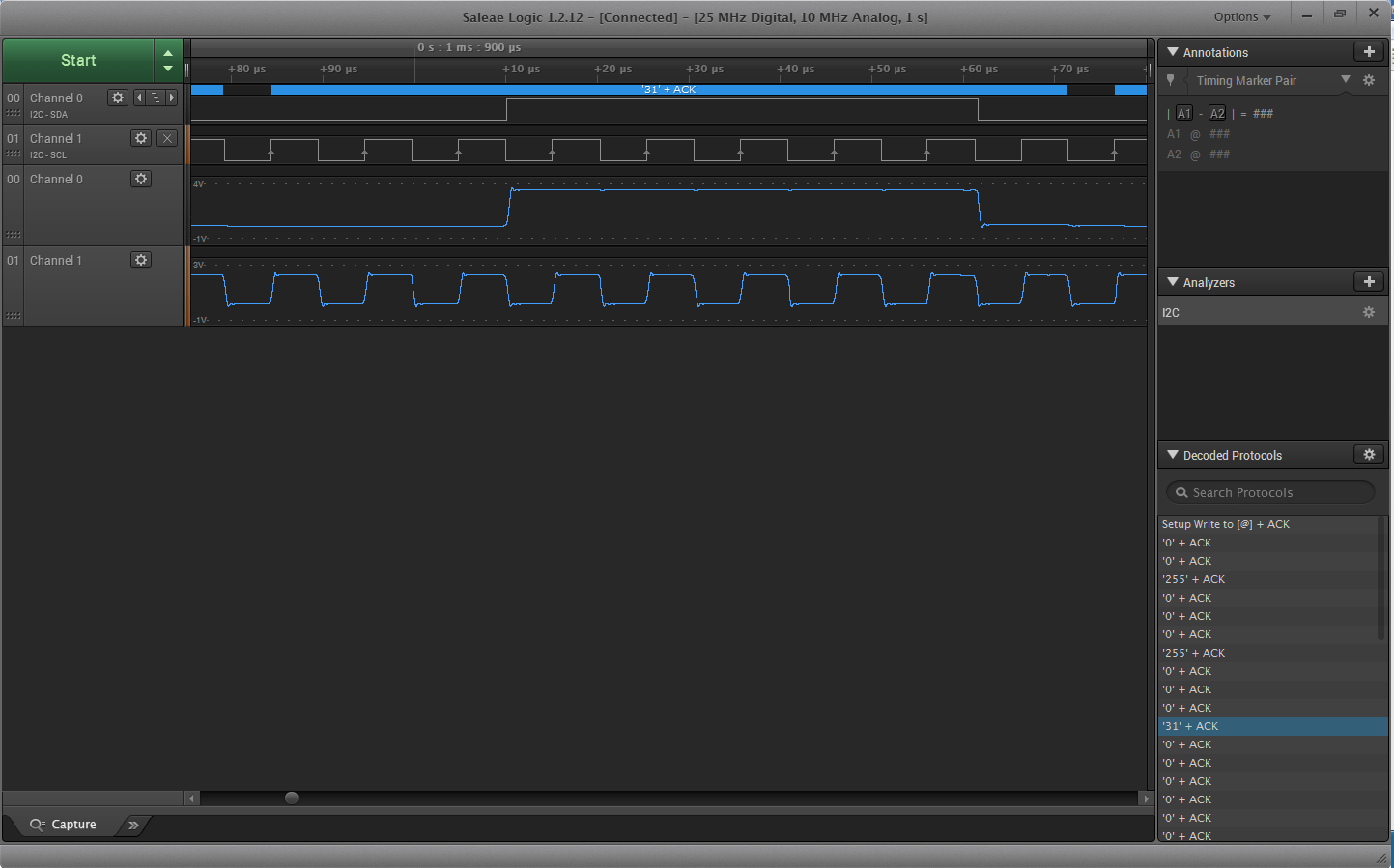

  • This was the result of the code below:

    From the logic analyzer it looks like the MSP took a nap and never woke up. Could this be the behavior described by USCI29 in SLAZ440H?

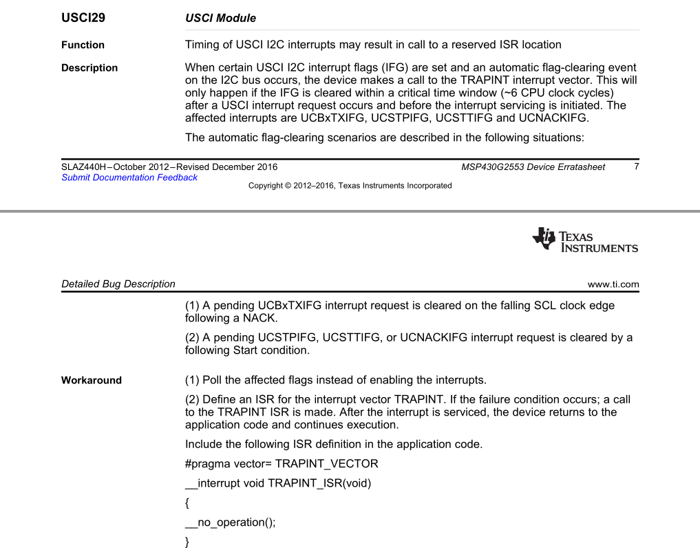

  • Solved my own question, when debugging I saw the PC was caught in the TRAPINT_ISR exactly like specified in the erratasheet. Work around #1 is guess what... poll the affected interrupts... Just have to live with the inefficiency then.
  • I'm glad to see that you've found the source of your issues although it is unfortunately from an errata. Thank you for providing your solution to the E2E community. Hopefully you will still be able to minimize your application's power consumption by shortening the amount of time spent communicating through I2C.
    Ryan
  • I'm glad too Ryan, perhaps the USCI's interrupt issue is actually a blessing in disguise. With the module active, the lowest power state the MSP430 can enter is LPM0. When in LPM0 the MSP still uses a whole order of magnitude more current than my intended state of LPM3.
    The USCI module's issue isn't so bad after all.
