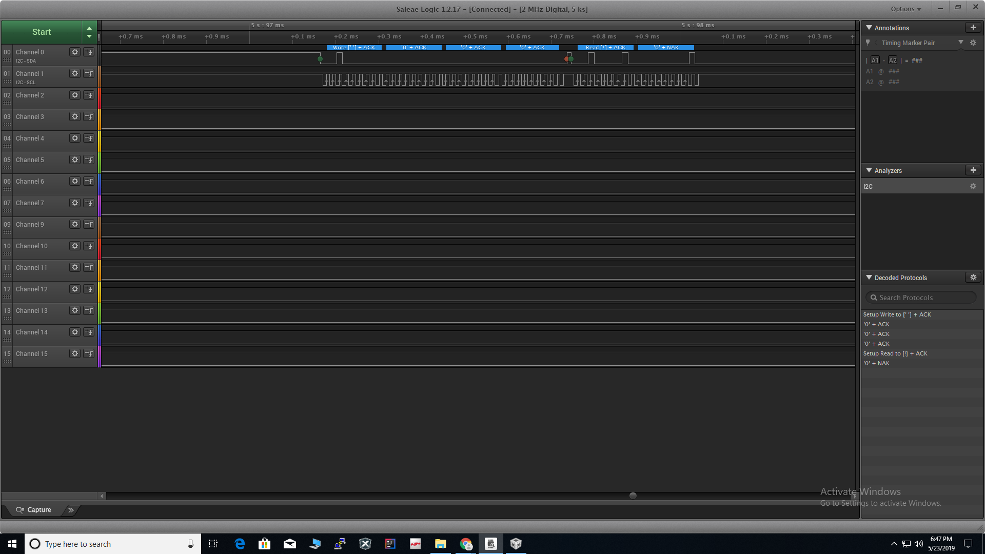

    I have added this statement. But I am still getting the same problem. The clock is not being generated on the SCL pin.
    I even connected pullup resistors between SCL SDA pins and 3.3V. I tried with both 9.2K and 4.7K resistors.
    I am uploading the picture  of the scope when I run the code.  I am also uploading the code.

  • I pasted line 45 from the .c file you posted. It was not a comment. Try searching for "P4SEL1" -- there should be no references to that name in this program.
    > P4REN |= 0xC0;
    > //P4OUT |= 0xC0;
    If you want to use the internal pullups (P4REN) you need to set the corresponding P4OUT bits to get them to pull in the right direction. You should un-comment the second line here, or -- since you have external pullups -- don't set P4REN at all.
  • Yes, Now I am getting the pulse. I have enabled the internal pullup and set the corresponding P4OUT bits. I uncommented that //P4OUT |= 0xC0; statement.
    But, I am getting the clock only once after I power up the board. I am not getting another time.
    If the remove the power and then plug it back, then I am able to see the clock signal.
    Thanks for your help.

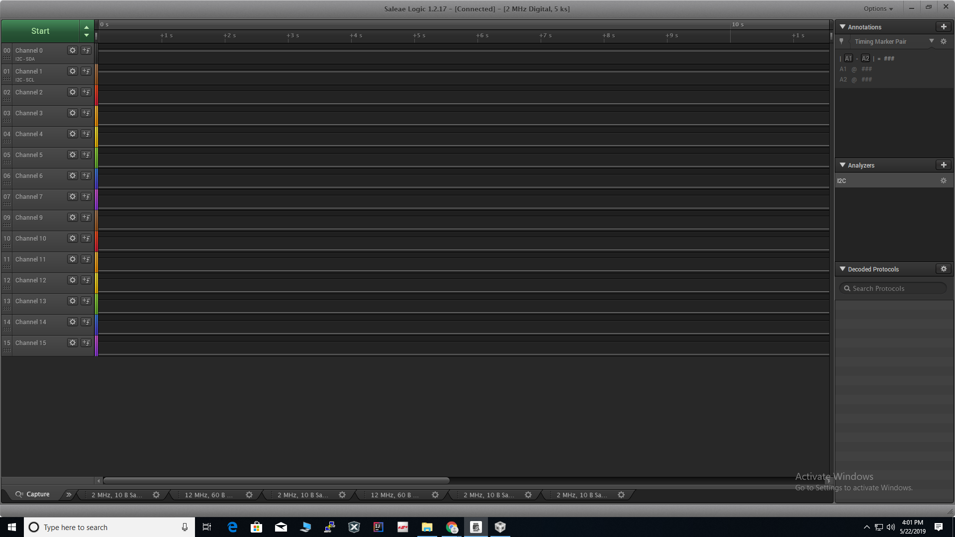

  • Please explain "once":
    1) Only one clock pulse (ever)?
    2) Only one transaction?
    3) All transactions, but only once?
    For (2): You appear to be doing a "MultiByteFinish" on a transaction you didn't "MultiByteStart"
    For (3): Your program does two transactions, then quits. Maybe you should enclose some of the transactions in a while(1) loop (maybe with a delay in between).
    When you pause your program, where is it executing? (Be sure to check the stack traceback to know who called whom.)
  • I am getting all the pulses but only once.
    If I run my code again it does not work.
    It works when I unplug the USB and plug it back.
    Moreover, it does not work when I debug and run it.
    It works only if i flash it onto the board.

  • Ok I will try that.
    I am using CCS.
    My problem is that, if I debug and run the code, it is not working i.e. no clock is being generated.
    It is working only if I flash it on to the board and then remove the USB and plug it back.
    When I run it like this I cannot see variables that I am using to receive the data from the slave.
    Can you suggest something for that.
