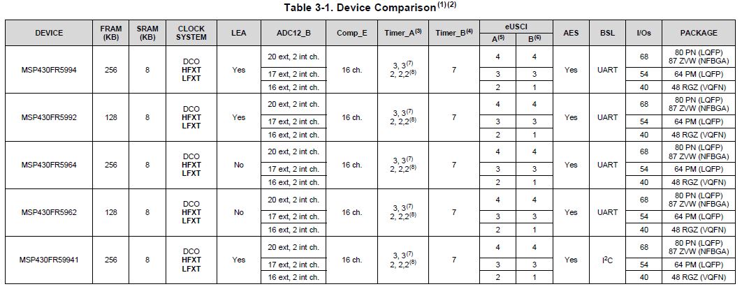

Hello Team,
I am trying to find out the difference between MSP430FR5994 and MSP430FR59941 for a customer.
Is the -941 an updated version of the -94, and if so, what changed between the two? I compared the datasheets side by side and could not differentiate it. Other then the lead ball finish, I cannot see any difference.
Is there anything I am missing ?
Thank you for  your help.
Kishen
  • Hi Kishen,
    Table 3-1 of the device's data sheet (SLASE54) shows the differences between the MSP430FR5994 and the MSP430FR59941:
    As can be seen the differences include the BSL interface. The MSP430FR5994 has a UART BSL interface whereas the MSP430FR59941 has an I2C interface.
