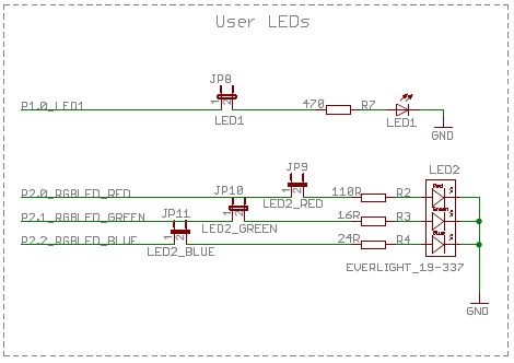

Newbie here. New to MSP as well. I am looking at the sample code for blinking the LED
int main(void)
    volatile uint32_t i;
    // Stop watchdog timer
    WDT_A_hold(WDT_A_BASE);
    // Set P1.0 to output direction
    GPIO_setAsOutputPin(
        GPIO_PORT_P1,
        GPIO_PIN0
    while(1)
        // Toggle P1.0 output
        GPIO_toggleOutputOnPin(
            GPIO_PORT_P1,
GPIO_PIN0
        // Delay
        for(i=100000; i>0; i--);
So you can see that port 1 and pin 0 are selected . How do I know which port/pin correspond to the LED?
Also what does this mean? WDT_A_hold(WDT_A_BASE);
  • From the schematic in the user guide, for one. It is also printed on the silkscreen on the board.
    The Red LED is on 1.0, and the RGB LED on 2.0, 2.1 and 2.2
    And the WDT stuff turns off the watchdog timer. The WDT is a safety feature. You arrange to signal the WDT every so often in your code. If the WDT does not see that signal it will reset the machine.
