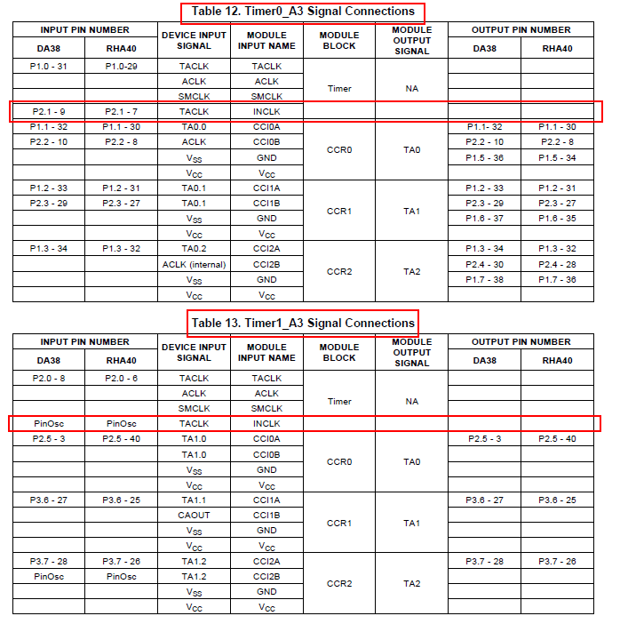

When its touched or not, meas_cnt[1] which should change, have no change and gives 0.

Hi satyendra,
I believe you issue is that you're using the wrong timer. On the G2553, Timer0_A3 has the appropriate internal connections for pin osc when selecting INCLK as the source. However on the G2955, Timer1_A3 has the appropriate connections as seend in Table 13 of the datasheet:
Hope this helps and let me know if this works.
Caleb Overbay
Hi Caleb,
i used TIMER! as you suggested it works well. I will let you know if I have any more problem. Thanks for your precious support it was very difficult to find what was going wrong.
