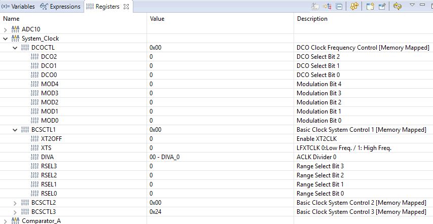

I am implementing a program to log analog values to SD card every 15 min, during ideal time DCO is wasting lot of power sitting there and doing nothing (can't use VLO as it is too inaccurate to track time). My logic is to reduce speed of DCO significantly during 15 min interval and then later increase it to default DCO value. The DCO clock speed is reducing down (I can make out from register value and low current consumption) but it is not reverting back to original DCO configuration. Can any one help with suggestion.
DCOCTL and BCSCTL1 are set to 0x0, but they are not revering back to original configuration which is DCOCTL = 0xA0 and BCSCTL1 = 0x8F
(Code and register values pasted below)

   BCSCTL1 = 0x0; // Set range
   DCOCTL = 0x0;
   delay(1000);
   BCSCTL1 = 0xA0; // Set range
   DCOCTL = 0x8F;
1) Initial clock register values ( DCOCTL = 0xA0 and BCSCTL1 = 0x8F)
2) Clock register values while the code is running (DCOCTL and BCSCTL1 have become 0x0, but they are not revering back to original configuration which is DCOCTL = 0xA0; and BCSCTL1 = 0x8F)

  • Thanks Caleb, after reducing the delay it seems to work fine, I will report more on this thread after extensive testing.
    Since PCB is already made, I can't use crystal. My bet was on using VLO clock source, but it drift significantly with voltage change. One more question, does rapidly changing DCO clock register in loop affect the life and performance of the controller.
