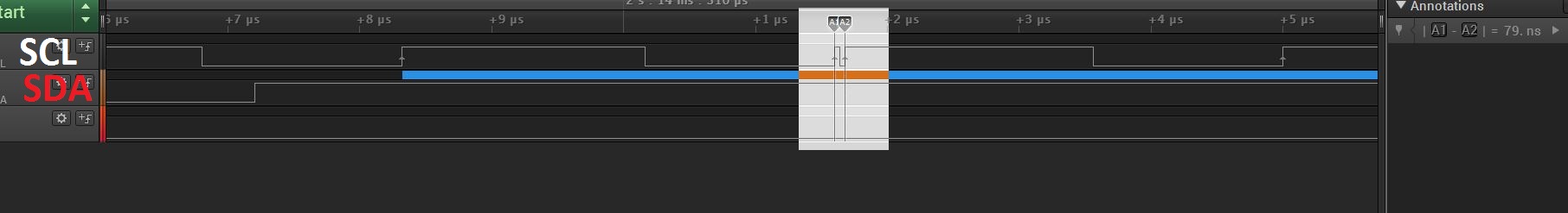

HI,
I am using MSP430FR5969 Launchpad and Trying to configure the MSP430 as I2C master and connect to slave device . I am using the Driverlib I2C driver "eusci_b_i2c.c - Driver for the eusci_b_i2c Module" and my configuration are below
EUSCI_B_I2C_initMasterParam param;
param.selectClockSource=EUSCI_B_I2C_CLOCKSOURCE_SMCLK;
param.i2cClk=CS_getSMCLK();
param.dataRate=EUSCI_B_I2C_SET_DATA_RATE_400KBPS;
param.byteCounterThreshold=0x0;
param.autoSTOPGeneration=EUSCI_B_I2C_NO_AUTO_STOP;
EUSCI_B_I2C_initMaster(EUSCI_B0_BASE,¶m);
What I observe is the I2C clock line frequently has a spike of about "80ns pulse " between a 1 clock cycle . Have attached the snippet of the same below
I am not sure why this spike is seen . sometimes I write are treated as Read commands because of spike becoming a valid clock pulse

I am not able to find the version of driverlib . But I have attached the same for reference .
I tried changing the I2C data rate ,but had the same issue [ 100khz and even lesser also ]. I can try to replicate without slave connected and confirm .
The pulse does not interrupt the communicated, but the transaction and data is misinterpreted like write command is interpreted as read command and data also .
