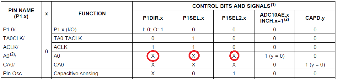

  • Glad to hear it works, but the input / output direction and the function selection bits are don't care for the ADC module - the configuration of the ADC overwrites the pin direction:
    So your solution is something else ;)
    Dennis
