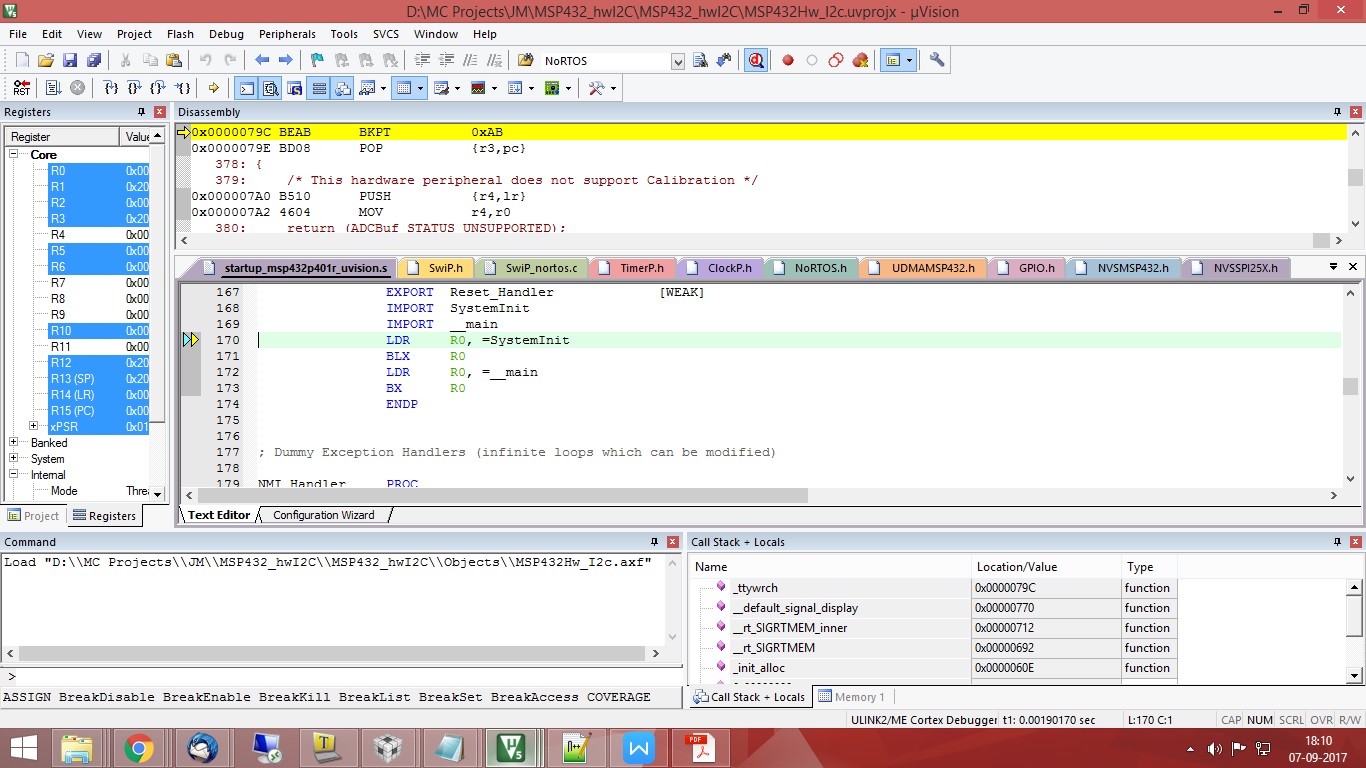

As suggested by Vikas Chola from TI. We used i2ctmp007 example from C:\ti\simplelink_msp432_sdk_1_40_01_00\examples\nortos\MSP_EXP432P401R\drivers\i2ctmp007 in keil but we are unable to execute.
It is stucked in SystemInit.
Here I attached whole i2ctmp007 project ported into Keil.
Please provide the solution.MSP432_hwI2C.zip

  • Sunil,
    I've run the code and I'm seeing the same thing as you on Keil. Also, since there are no Keil project specs for non-RTOS TI Drivers examples, I'm wondering what process you used to put this project together? Where did you get your project settings?
    -Bob
  • Sunil,
    One more update. TI Drivers are not currently supported on Keil. Have you tried re-creating your project using a Driverlib examples and APIs? There are examples with Keil project specs that would get you running faster.
