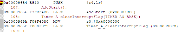

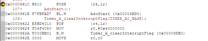

My customer is using MSP432P401R base on keil IDE. Now, they meet an issue when do the code optimization.  In TA0 interrupt service function, there are two tasks. One is trigger ADC interrupt, another is clear interrupt flag. If they set the optimization level as 01, the timer interrupt will be triggered frequently.
The code is as below:
void TA0_N_IRQHandler(void)
	AdcStart();
	Timer_A_clearInterruptFlag(TIMER_A0_BASE);

The assembly is as below with code optimization  (optimization level = 01):
The assembly is as below without code optimization  (optimization level = 00):
So could you give some comments about the issue? Thanks.
