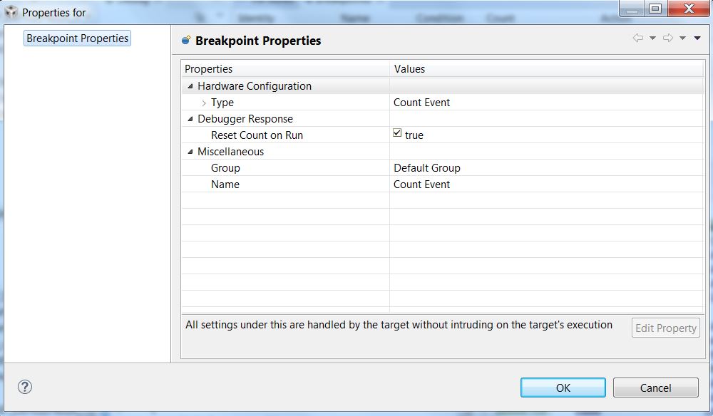

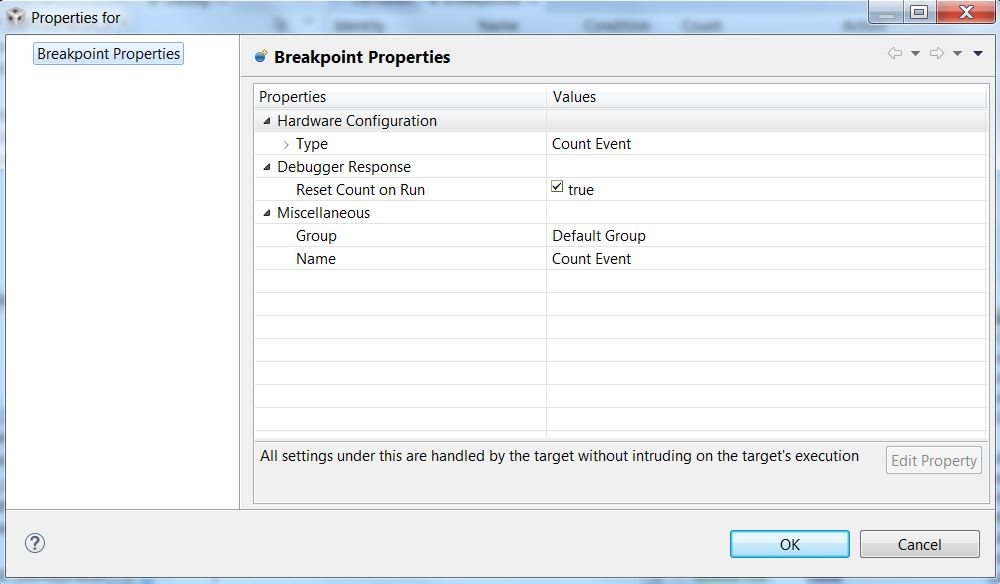

I'm I'm trying to find out how many cycles a loop takes. I'm using the cycle count feature in the breakpoint window of the ccs debugger. If I step through the block of code, I get a lot more cycles then if I were to execute the whole loop. For example, if I step through, I calculate that one interation of the loop is 2 cycles. So, assuming that if I execute the loop 1000 times, I should only get about 2000 cycles. However if I run the whole loop, I end up with something like 12,000 cycles. What am I doing wrong?

  • Thank you for your response Chris. I made a video to try to clarify what is happening. In this example, when I step through, I takes 3 cycles to execute the instructions in the loop (including the branch) and the loop is iterating 30k times. I would expect ~90k cycles if I did the whole loop. However, as you see at the end, I get ~360k cycles.
    https://youtu.be/Cg_v4gXmwbg

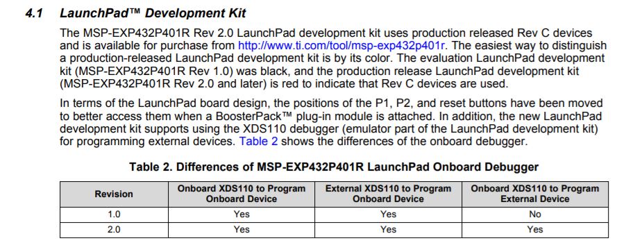

  • Thanks for the reply. Yes, I'm using the MSP432 LaunchPad (MSP-EXP432P401R rev 1.0). Is the problem specific to this revision?
    One other question about the video Artie, is the branch 2 cycles? Because you only have 3 instructions in the loop. Should it be ~90k cycles, not ~120k?
    John
  •  John,
       We do recommend that you move to the latest platform (revision 2.x of the launchpad and revision C or greater silicon).
    Chris
  • Chris,
    So it isn't working b/c of the Onboard XDS110?
    John
