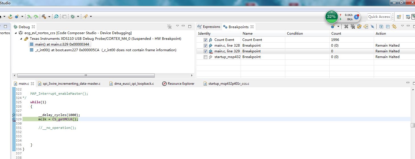

hi all:
I need me to get the exact time of the program.So the method of using COUNT clock cycle in CCS DEBUG . I use the __delay_cycles () precise delay program for 1000 clock cycles.
Then read the value of count to see if it matches.The breakpoint of the program and the settings of the CCS debug breakpoint count are shown in the following picture.
After the program is run, the clock cycle is not 1000, but 2987, between the two measuring breakpoints of the program.As shown in the following picture
This is my doubt, I accurately delay 1000 clock cycles, why the CCS breakpoint count calculates the clock cycle is 2987?

    I set a breakpoint at __delay_cycles(1000); and a breakpoint at mclk = CS_getMCLK(); made a count event, set reset count on run. Ran to __delay_cycles(1000); ran it again, and received the following count.
    If this does work, let me know.
  • Thank you very much for your reply.
    1. I've tried three programs, and the first program is exactly the same as yours. The result is the same as you, the delay of 1000 clock cycles, the count is also 999.
    2. In the second program, I used DCO and raised MCLK to 48M. After 1000 clock cycles, the count is 1996. program and the results are as follows.

  • Alex824,
    I can confirm that I see this behavior as well. I'm going to open an investigation into this to see what we can do about it. In the meantime, as I've been working with it, in a number of conditions, it seems to be accurate up to 24MHz clock operation. My suggestion would be to use it up to 24MHz or set up a timer that is sourced by MCLK to count clock cycles, starting the counter when you want and stopping it when you want while accounting for overflow.

  • Hi Evan:
    I found the reason for the deviation. The reason is that I set the FLASH waiting period of 2
    MAP_PCM_setCoreVoltageLevel(PCM_VCORE1);
    MAP_FlashCtl_setWaitState(FLASH_BANK0, 2);
    MAP_FlashCtl_setWaitState(FLASH_BANK1, 2);
    I changed the FLASH waiting period to 1, and then the machine cycle was calculated with COUNT,The deviation has been reduced a lot.
    __delay_cycles(1000); -->count = 1333
    MAP_FlashCtl_setWaitState(FLASH_BANK0, 1);
    MAP_FlashCtl_setWaitState(FLASH_BANK1, 1);
