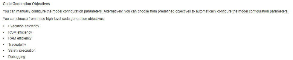

  • Hi Andrea,
    One other suggestion is to go beyond MATLAB Coder, and use Embedded Coder. Embedded Coder gives you full control over the generated code, and allows for generation of optimized code. The code that comes out of Embedded Code is as efficient, or more efficient then hand code.
    In addition you can select the main objective for your generated code from these choices: (doc link, login may be required)
    In your case, you probably would want to explore the ROM / RAM efficiency options.
    HTH,
    -Brian
  • Hi Brian,
    Embedded Coder is already installed on my computer, but it only adds a few more options to the Matlab Coder settings. I think to get full configuration possibilities (with the efficiency options), you need to generate code from Matlab Simulink, which I am not doing (I was only given a script with a few algorithms written in the standard Matlab editor). I also couldn't find a support package for MSP430FR5994 or similar devices. If you have more information about generating decent code from Matlab for the MSP430x, please let me know.
    Greetings,
    Andrea

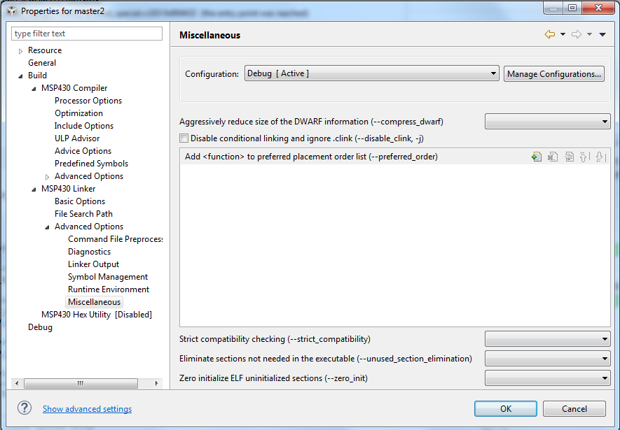

    which occurs because I put the .bss in FRAM2, which starts at adress 0x10000. Can I somehow change the settings to overcome this error? I found a similar post https://e2e.ti.com/support/microcontrollers/msp430/f/166/t/313159
    Where setting a flag in the GNU Linker->Miscellaneous options solved the issue. But I can't find the 'Other flags' section in my project settings; I am using MSP430 Linker.
    And here my properties window:
    I think this is the easiest way for me right now, to find a way to use the upper part of memory for my variables and data. If this is possible, that is.
    Greetings,
    Andrea
