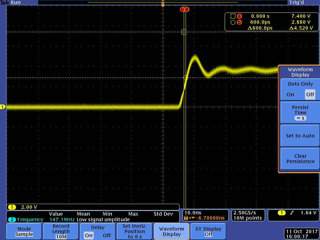

    I implemented the code you provided to generate a 1ms periodic pulse.   The jitter I am seeing with this code is approx. 100ns,  Is that what you would expect, given the jitter spec on the clock source DCO is 2ns?   In this scope trace I am triggering on the edge of the 1ms pulse and showing jitter on the following edge.  Is the jitter in your example proportional to the frequency used to clock the timer?  I am asking because I am using SMCLK sourced by DCO at 16MHz and I am seeing approx. 500ns of jitter over 4ms.
  • John,
    I just went to the lab and probed the timer and SMCLK signals and could not recreate what you are seeing. For the timer signal running at 1ms period, I am measuring a jitter of approximately 600ps and for the SMCLK running at 1MHz, I am measuring a jitter of approximately 1.2ns. Both of these measurements lie within the specification outlined in the datasheet.
    Are you using a launchpad to test your device? Are your trigger settings on your oscilloscope set up correctly?
