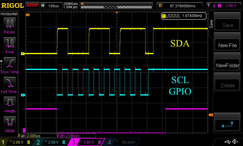

My MSP430 is working as the single master communicating to a single slave device the RT9528 charger. Usually, about 98% of the time it powers on and I2C works flawlessly. The other 2% gets stuck in a fault state with no communication and seems to be cleared only by power cycle (so far). On the faulty power-up, it seems that SDA/P1.7 never leaves logic low. I think the MSP is the one responsible because when I disconnect series resistor, MSP side is low (albeit it also removes pull-up) and the slave side is high (w/ pull-up). I try to detect when it happens in code and convert P1.7 to GPIO to attempt a toggle, but when I try this it only goes to 1V instead of 3.3V.

    It doesn't look like there is anything out of place on your schematic on the I2C lines between the MSP and RT9528. When the series resistor is removed, the voltage on the MSP side of the SDA line should remain low during I2C communication without the pull-up resistor because the MSP only drives the SDA line low and puts the pin in a high impedance mode to allow the pull-up resistor to drive the line high. Are you able to remove the series resistor and add a separate pull-up resistor between the MSP side of the SDA line to VCC and measure the SDA signal from the MSP when the RT9528 is separated? When you switched P1.7 to GPIO and toggled it high, was the series resistor on the SDA line removed when you measured it at 1V?

  • Hi Ryan,
    Thanks for your review. Ah-ha, you are absolutely right about why the MSP is low without series resistor.
    I've had big improvements by pulsing SCL P1.6 as a GPIO to clock out extra bits. It seems that the slave is in the middle of a transmission. Regardless of state of SDA on power-up, initialization now uses 8 clock pulses followed by a STOP condition, here is a case when SDA was held low on power-up:
    I think this confirms that SDA was held low by the RT9528. I am still running tests to see if any faults persist. Do you have any recommendation for using more or less than 8 pulses?
    When P1.7 was used as GPIO it was with the series resistor shorted.
    No way to way reset RT9528 without resetting MSP because SoC_VCC is able to backpower VUSB to 3V
  • Eight data bits plus one ACK/NACK bit add up to nine pulses in the worst case.

  • Thanks for the feedback Clemens and Ryan.
    I will leave it unchanged from scope picture since my STOP condition sends an additional falling edge for 9 total.
