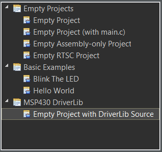

    Thank you for your post. These warnings are harmless. I've reported them, so they'll be fixed in the future. Your setup seems fine since you're not seeing any errors which is good. Also, there's no need for the TARGET_IS_xxxxxx #define.
    Since the source code is provided, your project can recompile its own driver.lib based on whichever compiler (there are several options available) that gets selected. How you set up the project for GCC is basically the preferred method. For the CCS compiler, there's a much easier way.
    If creating a new CCS project:

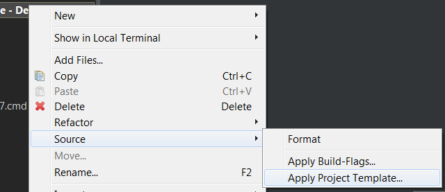

    If adding to an existing CCS project:
    NOTE: For the second method, you must have a version of MSP430Ware or MSP430 DriverLib installed and pointed to by CCS.
    Another option would be to create a CCS MSP430 DriverLib project and then change the compiler to GCC. However, you'd have to change the include path again manually, so this option isn't much easier/quicker than the others.

  • Hi James,
    Thank you for your response. How do I make msp430ware pointed to by CCS?
    I donwloaded msp430ware from the TI website and installed it and it created an msp directory under the ti folder. But I think it's not yet pointed by ccs. My CCS is also located in the TI folder. I downloaded the MSP430 and CCS separately and installed them separately. I tried to do the two options you described above but whenever I start a new project, I do not see the last two options. I just see Empty Projects and the items within it. I also tried going to source and apply project templates but there was nothing in there.
