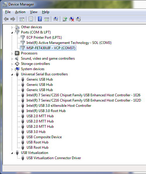

When I tried to download the project to the device IAR popped a message indicating that the EZ430 USB tool was outdated and requires an update... accepted and now the EZ430 emulator appears in device manager as an MSP-FET430UIF which is a completely distinct device.
Looking at other threads and posts I found that this was a known issue: IAR somehow confuses the EZ430 tool as an MSP-FET430UIF and uploads the FW on it rendering it useless.
My tool still can download the code to the flash but all UART and debugging capabilities are not working.

  • Hi Caleb,
    In my previous post I added photos and more comments however for some reason they are not shown... I tried twice and both posts have same problem so I'm adding here some of the missing part
    - I tried with both "COM37" and "TIUSB", according to the documentation this should make no difference.
    - As indicated in the documentation, I create the file cdc.log with the line "True" only (without this the tool fails).
    - I copied the msp430.dll and my .txt file to the execution folder.
    Then I run it (I use the debugger to step by step check the process):
    the MSP430_Initialize() returns Ok. The dialog opens and shows the DLL version 2.04.09.001 and MSP_FET430UIF version: 1.00.02.000.
    Then the dialog shows "Initializing Bootloader..." and then it displays "Could not initialize device interface" and stops there.
    Attached you'll find the dialog when it stops and also a pic of the device manager showing my device.
    The procedure seems straightforward and easy however doesn't work. The documentation about MSP430_FET_FwUpdate() is short and concise, maybe there's an undocumented option that I need to use.
    Thanks for your support again.
    e.
