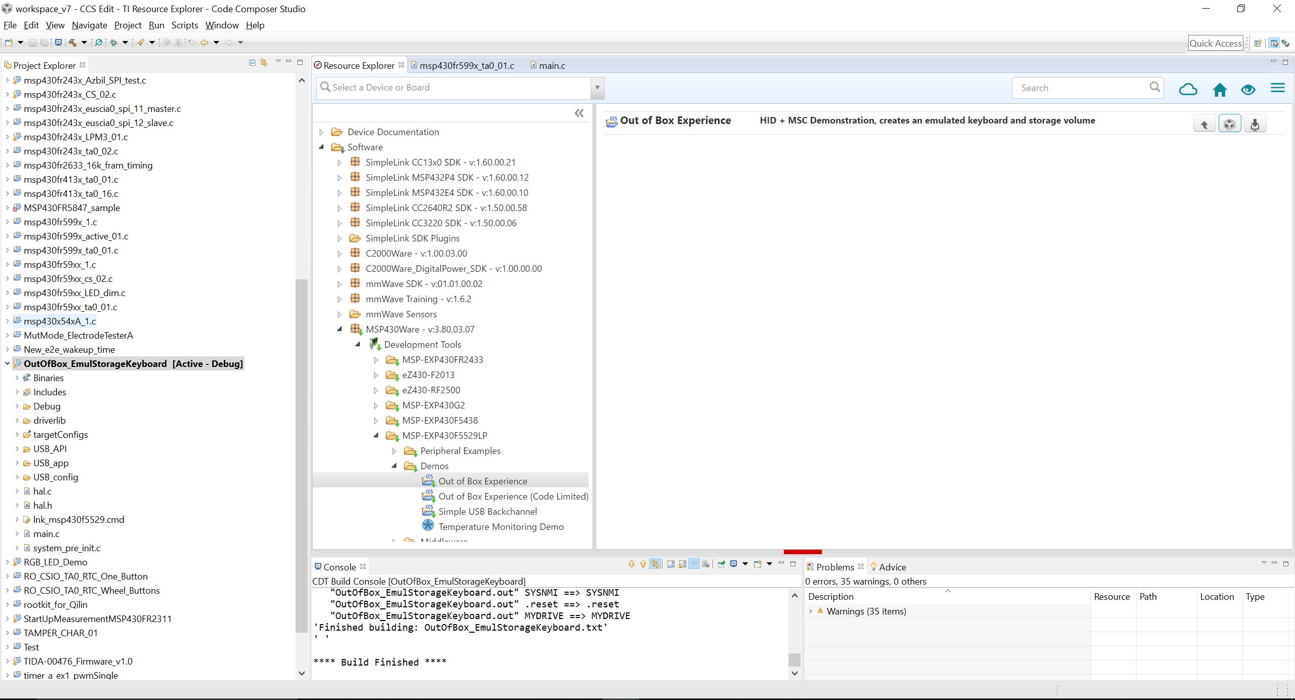

    There is one thing I want you to try first because there is always an issue with path dependencies when you are attempting to import a software library outside of CCS. Please follow the steps below:
    1) Open CCS and go to the Resource Explorer
    2) Ensure that the latest version of MSPWare is synced up with your Resource Explorer
    3) Use the left panel to click down into this path (Picture is below):
        Software -> MSP430Ware - v:3.80.03.07 (or any latest version) -> Development Tools -> MSP-EXP430F5529LP -> Demos -> Out of Box Experience
    4) Click the Out of Box Experience on the left panel
    5) Use the CCS logo button on the right side of the page to import the project to your CCS Project Explorer
    This should allow for a clean import of all of the required files and libraries to have a clean build and run of the User Experience demo.
    Matt Calvo
  • Thank you for your prompt reply. I was able to import the project from the Resource Explorer without warnings.

  • Unfortunately that has not solved my problem yet, as it is not the same demo program. It's about the UserExperienceDemo from this source:
    software-dl.ti.com/.../MSP-EXP430F5529_UE_Demo_Software.zip
