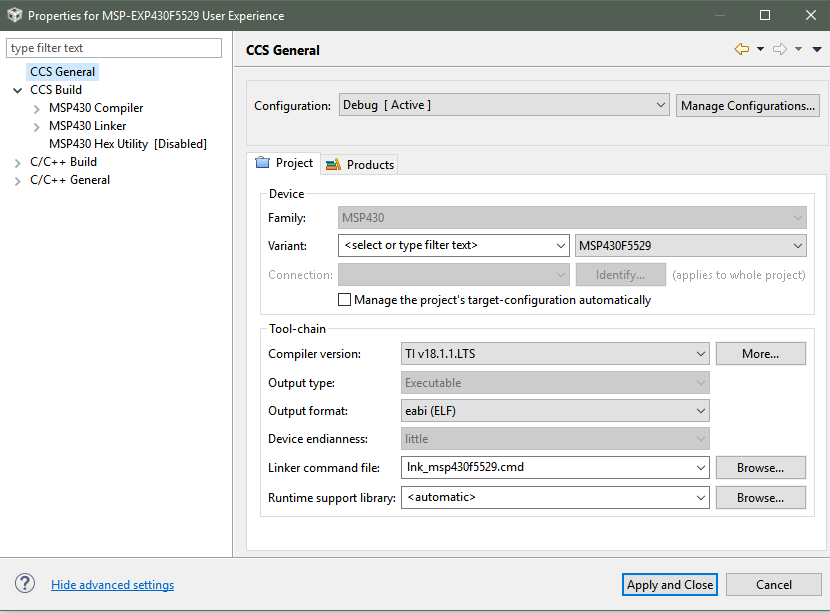

    the warning you are getting as the original project was made with an old compiler in a different format.  Try changing your compiler settings to look like the picture below. that actual number of your compiler may vary since you are on CCSv7.1 . Even after doing this, you may get the message that the project won't fit. Again this is a discrepancy between the older version of CCS this project was created with and the newer format. I had to copy over a newer version of the MSP430F5529 linker file from an up to date example code to this project for it to work

    I'd like to say that I finally got to build and upload the code without no errors using Windows 10. Here follow the steps I took since the beginning (can help others too):
    1.Download and install CCSv8.0.0
    2.Download the "MSP-EXP430F5529 Experimenter Board User Experience Demo Software Package" from this link: http://software-dl.ti.com/msp430/msp430_public_sw/mcu/msp430/MSPEXP430F5529UE/latest/index_FDS.html
    3.Run the installer. This installer provides the "out of the box" project.
    4.Imported the out of the box example at CCS using project -> import CCS projects -> select the folder the installer download -> check the MSP-EXP430F5529 User Experience -> check the both box to copy the project to the workspace and make the file references.
    5.After imported, I clicked at the project -> properties -> changed the compiler version to v 18.1.1 and the output format to eabi (ELF).
    6. I installed the MSP430Ware from the own CCS.
    7. Imported the more basic example (blink led) from the MSP430Ware at the own CCS. Deleted the file "lnk_msp430f5529.cmd" from the "out of the box" example, copied the same file from the blink led example and them pasted at the "out of the box" project. And finally no error, 1 warning, built it and uploaded to the board, it runned!
    So, thanks Jace for your recommendations that solved my problem in Windows, but this did not solve my problem at Linux (which I followed exactly the same instructions).
