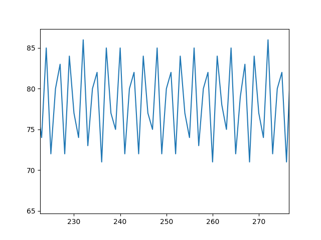

  • Thanks for you response. I tried the changes that you recommended but I'm still not getting a wave to come through well. I attached a picture of what the graph that I'm getting looks like from a 50 Hz sine wave. Is there maybe something I should do to make sure that each value sends before the ADC reads another value? The fastest wave that I will need to capture will only be around 10 Hz, so 480 Hz from 9600 baudrate should be more than sufficient. Thanks in advance!
  • This graph seems to suggest that each cycle has about 4 samples rather than the expected (960/50)=~20 samples, so maybe there's something else going on. (Or it could be an illusion.)
    Can you show your new code? As it was structured, it was sampling much faster (~250:1) than it needed to , but as a consequence the sample sent at the UART rate was always (I believe) fresh.

    This is my code after making the changes. The more I've been thinking about it though, the more I think that my problem might actually be with either my Bluetooth module or the Python code I'm using to receive and plot the data. I'm open to any further suggestions as far as the embedded code though.
  • I tried changing the location of my line of code for transmitting but then I wasn't getting anything on my computer. Would I have to write the code differently to transmit in a different location rather than just setting UCA0TXBUF = ADC10MEM? I'm still pretty new to writing embedded code besides for Arduino, so I still have quite a bit to learn.
  • I agree that this isn't necessarily the most efficient way of doing this, but as I read your code (I don't have the equipment to try it) it should be giving much better results.
    Is there a way to check the other elements in the signal chain (Bluetooth, Python)?
  • That's what I was trying to work on today. I verified that Python code is receiving the hex data from the BT module and converting it to decimal values correctly so now I think my next step is to see if something weird is happening in the BT module itself. The module I'm using is an AMS001 incase anybody has experience with it and might be able to give some advice. I'm also new to BT communication so it's completely possible I'm making a simple mistake there as well. If not, I might just have to see if I can find another forum somewhere where I can get some help troubleshooting the BT.
