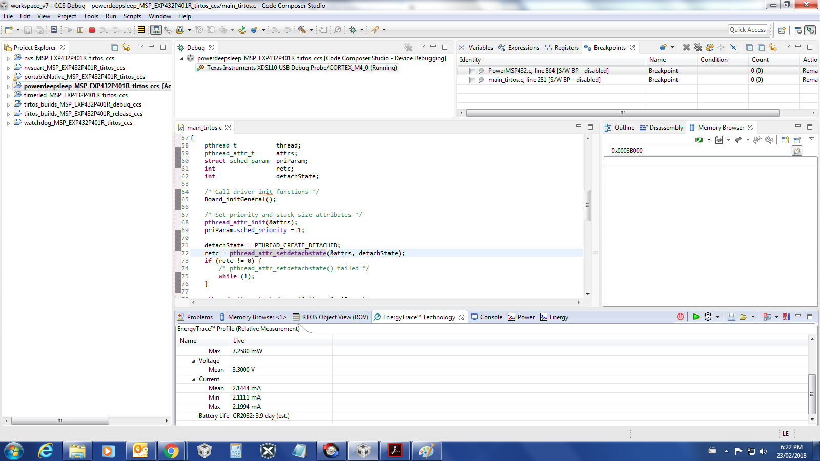

Initially I tried to run the "powerdeepsleep" example and found the when the msp432 goes into deepsleep mode by pressing the SW1 on the launchpad the value of "sleepstate" variable in the function "int_fast16_t Power_sleep(uint_fast16_t sleepState)" found in the PowerMSP432.c file changes to 4 (which is the macro value of PowerMSP432_DEEPSLEEP_1 as defined in the PowerMSP432.h file.
The current still is in milliamps (over 2 mA) as compare to 1.6uA that was mentioned in the post for which I have attached the link above.I have also attached screen shot for the current drawn measured and also when the state is changed.

Due to this the idle mode current drawn in my application shows 20 mA which is too much since ours is battery operated application.

  • Hi Amit,
    thank you for this feedback. But i believe you have not tried with the FatFs library and the functions that you have tried are C file library.
    My firmware has to use the FatFs library and that is what creating the issues.
    I had also posted this earlier.
    Not sure whether this is related to the SDK version that you mentioned in your another post.
    Vikram
  • Hello Vikram,
    It uses the Fat FS drivers internally. The FatFS are wrapped in the SDFatFS to make them POSIX compliant.
  • it looks different since in the FatFs approach we have functions such as f_open, f_write and so on whereas the one that you have sent is fopen, fclose and fwrite.
    Also the library used is console library i.e. ffcio.h whereas i have to use the ff.h library
  • Hello Vikram
    If you look at the change log for the latest SDK, it has a history of changes. Somewhere around 1.60 release the change was made.
    If you have the latest SDK, you can at least evaluate the project to see if it is getting you the functionality with the correct power numbers.
