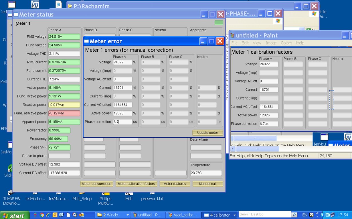

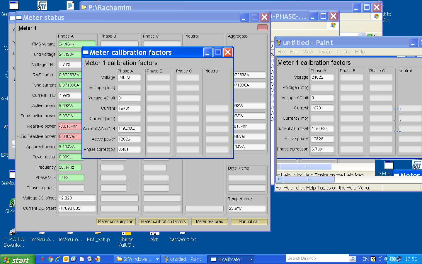

  •  I used
    - MSP430i2040 Embedded Metering EVM &
    - calibrator-20121120 &
    - Submeter i2040 8k_DC_THD_AUTO_OSR_IAR5.5_customer
    I cannot update "Meter 1 calibration factors"
    When I write the parameters and read again, I get "gibberish"
    write new parameter:
    read after write:
    Please keep in mind that you'll need to enter a percentage (%) increase or decrease in the Meter Error window (excluding the phase correction). Notice the units on the right of the entry boxes. After making changes in this window, the updated calibration factors will be shown in the Meter Calibration Factors window.

  • Thanks James for the answer,
    I'm trying to run "i2040-TWO-PHASE-CONFIGURATION" software on "MSP430i2040 Embededd Metering EVM" hardware.
    I have changed all the calibration factor as it appears in "Submeter i2040 8k_DC_THD_AUTO_OSR_IAR5.5_customer"
    #define DEFAULT_V_RMS_SCALE_FACTOR_A 24022 /* 13428 rachamim */
    #define DEFAULT_V_DC_ESTIMATE_A 34 /* 0x0000 rachamim */
    #define DEFAULT_V_AC_OFFSET_A 0 /* 9 rachamim */
    #define DEFAULT_I_RMS_SCALE_FACTOR_A 16701 /* 21777 rachamim */
    #define DEFAULT_I_DC_ESTIMATE_A 39757 /* 0x0000 rachamim */
    #define DEFAULT_I_AC_OFFSET_A 1164634 /* 0 rachamim */
    #define DEFAULT_P_SCALE_FACTOR_A 12826 /* 9368 rachamim */
    #define DEFAULT_BASE_PHASE_A_CORRECTION 7 /* 4 rachamim */ //12
    #define DEFAULT_I_RMS_SCALE_FACTOR_NEUTRAL 24410 /* 21740 rachamim */
    #define DEFAULT_I_DC_ESTIMATE_NEUTRAL 0 /* 0x0002 rachamim */
    #define DEFAULT_I_AC_OFFSET_NEUTRAL 0 /* 11 rachamim */
    #define DEFAULT_P_SCALE_FACTOR_NEUTRAL 12565 /* 9302 rachamim */
    Most data in the meter_status window, is normal :
    RMS voltage : correct
    Frequency : correct
    Except:
    RMS current : incorrect
    Active power : incorrect
    Please, what needs to be changed to make it work.
    Rachamim

  • Hi James,
    Now it's working
    After I changed file "meterilogy_template.h" :
    from:
    #define SD_LIVE_CURRENT_GAIN SD24GAIN
    to
    #define SD_LIVE_CURRENT_GAIN SD24GAIN_16
    Rachamim
