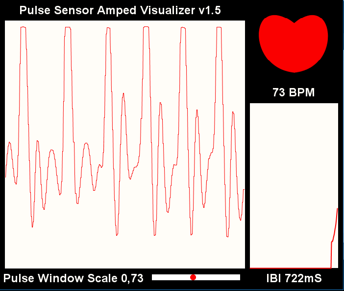

  • Hi, thanks for the suggestions.
    I've checked if the pulses are correctly with Arduino Processing. Attached a screenshot about pulses.
    If the codes are correct, there might be some position problems between my finger and the sensor :) Sometimes I read really close values to the actual values with Processing app. But it's not stable. Sometimes I get "0" pulses.
  • I'm not sure I understand well what the analog section is doing, and that instructables page doesn't explain much. Your scope trace doesn't look very "digital", so those low-amplitude pulses might not be bit enough to trigger the pin logic.
