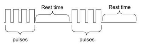

The code generates 20µs pulse width spaced 50µs apart. How can I modify the code to be able to generate pulse train at a frequency of 50Hz with rest time, as shown on the image?
I'm new to msp430 registers and many things to learn. Your help will very much be appreciated.

  • Hi Kim,
    You could try using another timer to modulate the first timer. Unless, do you just need a single pulse? This could be doen with PWM generation.
  • Hi Cameron,
    I do not undestand your statement: You could try using another timer to modulate the first timer.
    What do you mean?
    How it can be done?
  • A simpler method might be to just count periods: Interrupt once per period (I suggest the CCR1 CCIE), and use that to increment a software counter. On period 4, change the OUTMOD to 0 (with OUT=0), to suppress the pulse generation. When the count gets to 1004-1, set the OUTMOD back to set/reset and set your software counter back to 0.
    This is analogous to what Cameron LaFollette was suggesting, but doesn't consume another timer.
  • Thanks for the response. I'll try those ideas however I'm confused using MSP430s registers and having a hard time to implement. Maybe you could provide some code snippets.

  • Wow. Thank you so much Bruce. I'll try it later if I have my oscilloscope.
  • First bug report: I'm pretty sure the first-ever pulse doesn't happen, i.e. the first burst has only 3 pulses. I'm also pretty sure this fixes it, but I don't have a scope here and it's hard to see on the LED:
    Replace:
    TA0CTL = TASSEL_2 | ID_3 | MC_1 | TACLR; // SMCLK, /8, Up (,Clear)
    with
    TA0R = SHORT_PERIOD-2; // Force EQU0 real soon, to get first pulse
    TA0CTL = TASSEL_2 | ID_3 | MC_1; // SMCLK, /8, Up (,No Clear)
  • The code works. I have just test it on my scope. Thanks Bruce.
