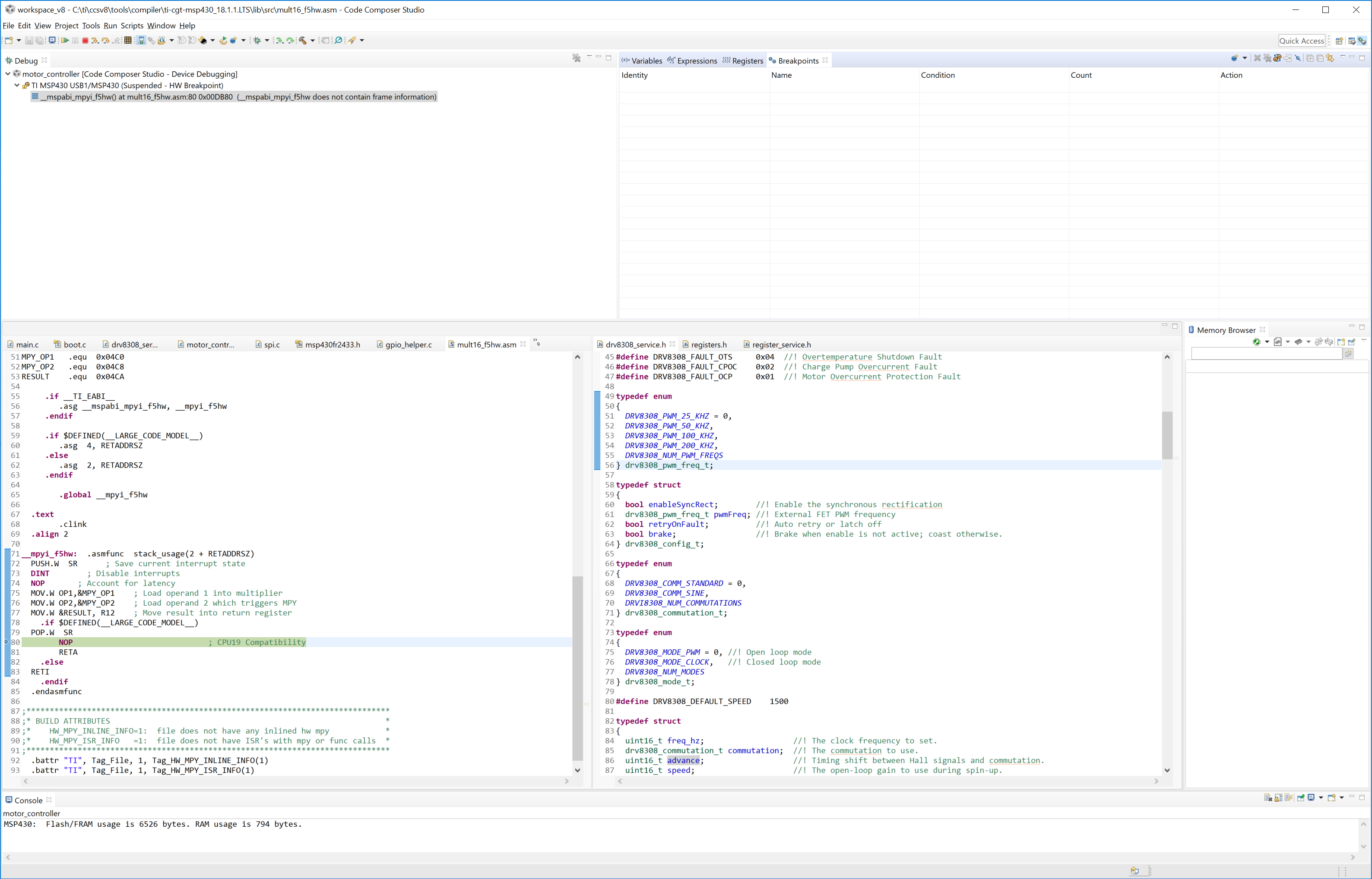

See the attached screenshot. CCS keeps hitting a phantom breakpoint in __mpyi_f5hw in mult16_f5hw.asm. This is making debugging impossible. I'm using CCS version 8.0.0.1, the new version of the MSP-FET using Spy-Bi-Wire and a MSP430FR2433 on our own development board.

  • Hi Rob,
    Thanks for bringing this issue to our attention. In order to better determine what is causing this, I'd like to understand if there is a specific execution sequence that is causing the problem.
    - Do you hit the phantom breakpoint right at the start of the debug session, or after some period of time? Is is consistent and repeatable (happening always and within the same amount of time after start-of-execution), or more random in occurence?
    - Is your program modular enough that you can disable portions of the software one at a time to see if the issue goes away, and then we can build back up until we find the component that is causing it?
    Walter
  • One more question- Are you transitioning between power modes as well? (i.e. active mode to LPM's back to active mode)?
    (ROB) It's random on occurrence, but almost always happens if I give it enough time. Stepping through the phantom breakpoint resumes execution normally.
    (ROB) Yes, I'll experiment with doing this, but because the phantom breakpoint is random in nature it will be difficult to figure out if what I've excluded has solved the issue.
    (ROB) I am not yet using any of the low power modes.
  • Hi Walter,
    I have an update. The phantom breakpoint is hitting before interrupts are even enabled! It's reliably hitting while I'm initializing my 'GPIO helper' driver callbacks. See the snippet below:
    uint16_t i = 0;
    uint16_t j = 0;
    for(i = 0; i < GPIO_NUM_PORTS; i++)
      for(j = 0; j < GPIO_NUM_PINS; j++)
        pinConfig[i][j].callback = NULL;
    Here's the callback definition:
    typedef void (*gpio_helper_int_f)(gpio_port_t port, gpio_pin_t pin);

  • Hi Rob,
    I am working on a setup to reproduce your issue for analysis. When you see this issue, do you have any real/intentional breakpoints set at other locations (besides the phantom location where it gets stuck), or doe the issue occur when you have no breakpoints set at all?
    Walter
  • Hi Walter,
    No breakpoints. I originally thought that the phantom breakpoint might be from a 'hidden' breakpoint so I explicitly disabled all breakpoints. The issue still presented itself.
    -Rob
  • Hi Rob,
    Are you still seeing issues here?
    If so, are you running at >8 MHz execution speed? We've been digging into this debug behavior and have seen that this debug halt seems to occur at 16 MHz but not at 8 MHz in some of our testing. I would be interested to know if it goes away if you run at 8 MHz.
    Walter
