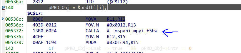

So next I stepped through my code, and I can see where the _mspabi_mpyi_f5hw() function is getting called:
It's not entirely clear to me why the compiler-produced assembly code puts in this call to __mspabi_mpyi_f5hw, but that's not he primary concern. I really would like to know why CPU execution stops at the NOP in_mspabi_mpyi_f5hw in the debugger only when running at 16MHz, and not at 8MHz?

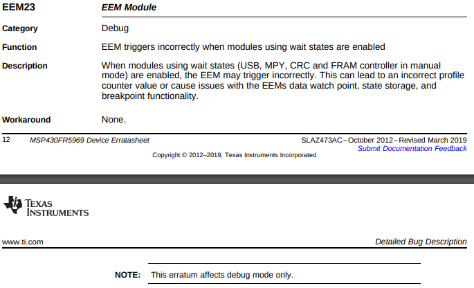

3. Having looked at the MSP430FR5969 Device Erratasheet there is the following:
Given that the phantom breakpoint occurs when using the FRAM controller with one wait state enabled in the FRCTL0 maybe EEM23 explains the cause. Hopefully a TIer will be able to clarify if this explains the problem.

In particular, #3 the FR5969 errata relating to EEM is a very likely candidate because:
1. The issue is not specific to my code, ans others have reported this *exact* issue previously with no posted resolution (see the posts I referenced in my original post.
2. My issue only occurs in debug mode at 16 MHz where 1 FRAM wait state, which matches the symptoms described in the errata.
Since there is no workaround listed in that erratum, perhaps the issue can be "resolved" after upper Tier reply, so that others posting as I did will become aware of your finding.
Thanks so much for help with getting to the point where I understand why it's occurring.

Hi John,
As you described, this problem will only occur in Debug mode, is normal in the case of free run, thus the root cause of the problem is EEM23 as described by Chester Gillon. Since this bug does not affect the normal use of the product, we have not list workaround in that erratum.
Thanks.
