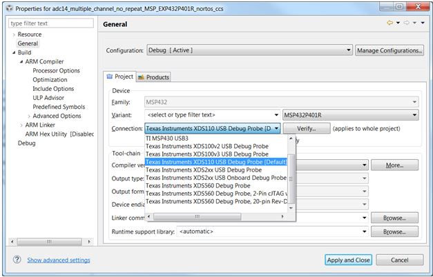

  • Sean,
       I will reach out to the tools team.  I am concerned that it says MSP430 and not MSP432.  Can you confirm that you are using the MSP-FET Adapter,  ?
    Also, that you have selected the correct connection within CCS?
    Chris
  • Hi Chris
    Thank you for your reply, I'm actually not using the adapter as we are not using an ARM standard JTAG connector. We have our own small adapter (just a bunch of connectors, no active circuitry) that converts the connector on the MSP-FET debugger to the connector on the board. I have made a bid to move to the ARM standard connectors in the past but it hasn't always been well received! :)
    What bugs me is that it will program just fine using UNIFLASH, yet on CCS, this error persists even without the debugger plugged in at all!
    i HAD adjusted the settings for the probe in the CCXML file, but I had NOT made the adjustments in the project menu you showed in the screenshot. Unfortunately making this adjustment made no difference :(
