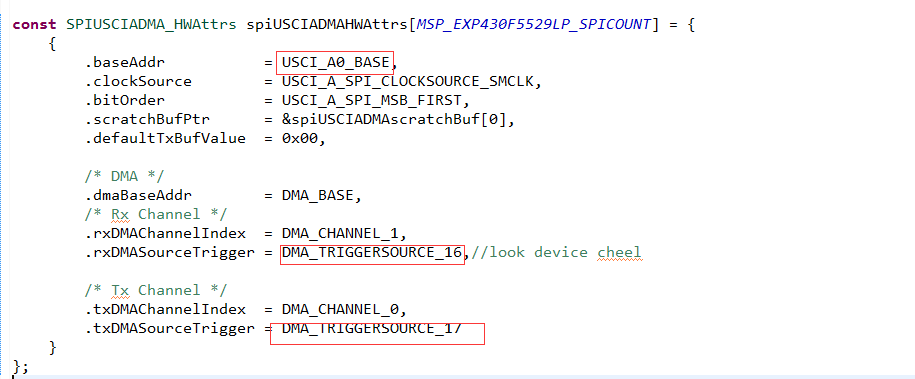

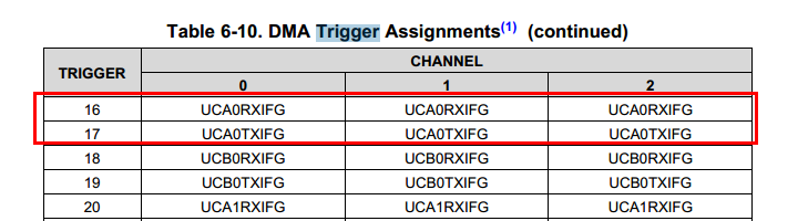

2. MSP_EXP430F5529LP.c
 *  =============================== DMA ===============================
 *  ======== MSP_EXP430F5529LP_isrDMA ========
 *  This is a application defined DMA ISR. This ISR must map and call the
 *  appropriate Driver_event(handle) API to indicate completed DMA transfers.
Void MSP_EXP430F5529LP_isrDMA(UArg arg)
    /* Call the SPI DMA function, passing the SPI handle used for WiFi */
    SPI_serviceISR((SPI_Handle) &(SPI_config[0]));
 *  =============================== SPI ===============================
/* Place into subsections to allow the TI linker to remove items properly */
#if defined(__TI_COMPILER_VERSION__)
#pragma DATA_SECTION(SPI_config, ".const:SPI_config")
#pragma DATA_SECTION(spiUSCIADMAHWAttrs, ".const:spiUSCIADMAHWAttrs")
#endif
#include <ti/drivers/SPI.h>
#include <ti/drivers/spi/SPIUSCIADMA.h>
SPIUSCIADMA_Object spiUSCIADMAObjects[MSP_EXP430F5529LP_SPICOUNT];
uint8_t spiUSCIADMAscratchBuf[MSP_EXP430F5529LP_SPICOUNT];
const SPIUSCIADMA_HWAttrs spiUSCIADMAHWAttrs[MSP_EXP430F5529LP_SPICOUNT] = {
        .baseAddr           = USCI_A0_BASE,
        .clockSource        = USCI_A_SPI_CLOCKSOURCE_SMCLK,
        .bitOrder           = USCI_A_SPI_MSB_FIRST,
        .scratchBufPtr      = &spiUSCIADMAscratchBuf[0],
        .defaultTxBufValue  = 0,
        /* DMA */
        .dmaBaseAddr        = DMA_BASE,
        /* Rx Channel */
        .rxDMAChannelIndex  = DMA_CHANNEL_1,
        .rxDMASourceTrigger = DMA_TRIGGERSOURCE_18,
        /* Tx Channel */
        .txDMAChannelIndex  = DMA_CHANNEL_0,
        .txDMASourceTrigger = DMA_TRIGGERSOURCE_19
const SPI_Config SPI_config[] = {
        .fxnTablePtr    = &SPIUSCIADMA_fxnTable,
        .object         = &spiUSCIADMAObjects[0],
        .hwAttrs        = &spiUSCIADMAHWAttrs[0]
    {NULL, NULL, NULL},

3. .cfg
/* ================ Hwi configuration ================ */
var halHwi = xdc.useModule('ti.sysbios.hal.Hwi');
var msp430Hwi = xdc.useModule('ti.sysbios.family.msp430.Hwi');
halHwi.checkStackFlag = true;
//halHwi.checkStackFlag = false;
var hwiParams = new halHwi.Params();
/* DMA Hwi for the SPIUSCI driver */
//SPIUSCIBDMA_hwiIntFxn
//DMA_VECTOR      50
//USCI_B0_VECTOR  55
//USCI_A0_VECTOR  56
hwiParams.arg = 0;
halHwi.create(50, "&MSP_EXP430F5529LP_isrDMA", hwiParams);
