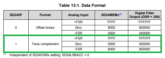

The values read by the ADC are half than those measured with a voltmeter. So I've multiplied them with 2.
My questions: is it expected for SD24 to return half values when working in single ended configuration, with 2's complement output format? Am I reading the values correctly?
    The SD24 will return a value that's between +Full Scale Range (FSR) and -FSR. Since you're using a gain of 1, the +/-FSR is +/-928mV. However, your input circuitry (probably voltage dividers) will impact how much of that FSR you're using at the maximum input voltage. Ideally, you'd want to use the full range. Basically, what you're seeing is normal, but you'll need to calibrate the device.
    Let's assume the device measures an input voltage within +/-FSR. However, this isn't in human terms, but MCU terms. Thus, you need to calibrate it at a certain known input voltage, which would allow you to calculate the necessary scaling factor that translates the MCU results (e.g. 0x1234) into human results (e.g. 3300mV).
    Does this make sense?
    James
    MSP Customer Applications
  • Hi! Please help me understand this correctly. This is how I see things now:
    +/-FSR is +/-1.16V (as I understand from the datasheet, since it uses internal reference).
    +FSR means to me 1.16V (0x7FFFFF), FSR/2 means 0.58V (0x000000) and -FSR means 0 (0x800000). I am working in 2's complement, single ended configuration (negative input Connected to GND).
    The voltage measured with the voltmeter is ~220mV. My code returned ~110mV, so it seems I have to multiply by 2 to get the real voltage (I forgot to mention in the code, LSB = 1.16/2^24)
    Shouldn't it return 220mV or is there a problem with my code?

    I've tried setting the output format to offset binary, which means that 0x000000 is 0V and 0xFFFFFF is 1.16V. Using the following conversion I get ~600mV, where it should be ~220mV.
    Ch0results_float[i] = Ch0results[I] * LSB;

    What do you get BEFORE multiplying the result with LSB? This is the reading: 0x0018632F. After multiplying with LSB*2.0, I get 0.222916409, where LSB is 1.17/16777216.0. Why do I have to multiply it with 2?
    I think I just figured out the issue. It's because you're dividing by 2^24 instead of 2^23. Remember, for the maximum positive number, you'll only have 23 bits, not 24 bits. For example, take a look at Equation 1 in the Measuring Single-Ended 0- to 5-V Signals with Differential Delta-Sigma ADCs app note.

  • Thank you for the solution and app note. It answered my questions.
