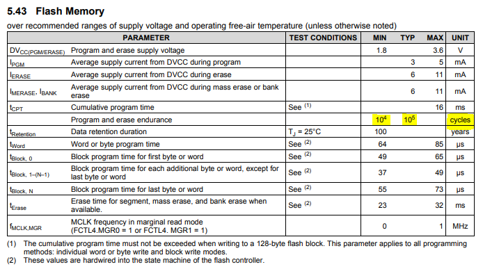

I did not find this limit inside the datasheet:
How many information flash write operations can aMSP430F5419A withstand?
best regards
Mich

As discussed in the Understanding MSP430 Flash Data Retention app note, the practical limit is around 100,000 flash erase/write cycles. However, our newer FRAM devices have nearly inexhaustible write endurance (10^15 write/read cycles), which is not a practical concern.
MSP430™ FRAM Quality and Reliability
MSP430™ FRAM Technology – How To and Best Practices
