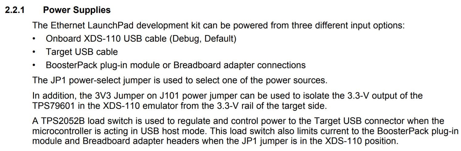

1. can i power on the kit using the mini usb near by RJ45 connector in the launchpad.

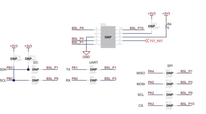

2. To configure it ifor uart data transfer am i need to use the R5 & R6 resistors as shown in the figure or these are for serial boot loading.
Thank you

  • and what about that mini usb near by ethernet connector. Can I power on the microcontroller using that mini USB?
  • You do not need to inlcude resistors R5 and R6 unless you are providing a BSL connection via the BSL connector.
    The power can be applied to the USB target connection.

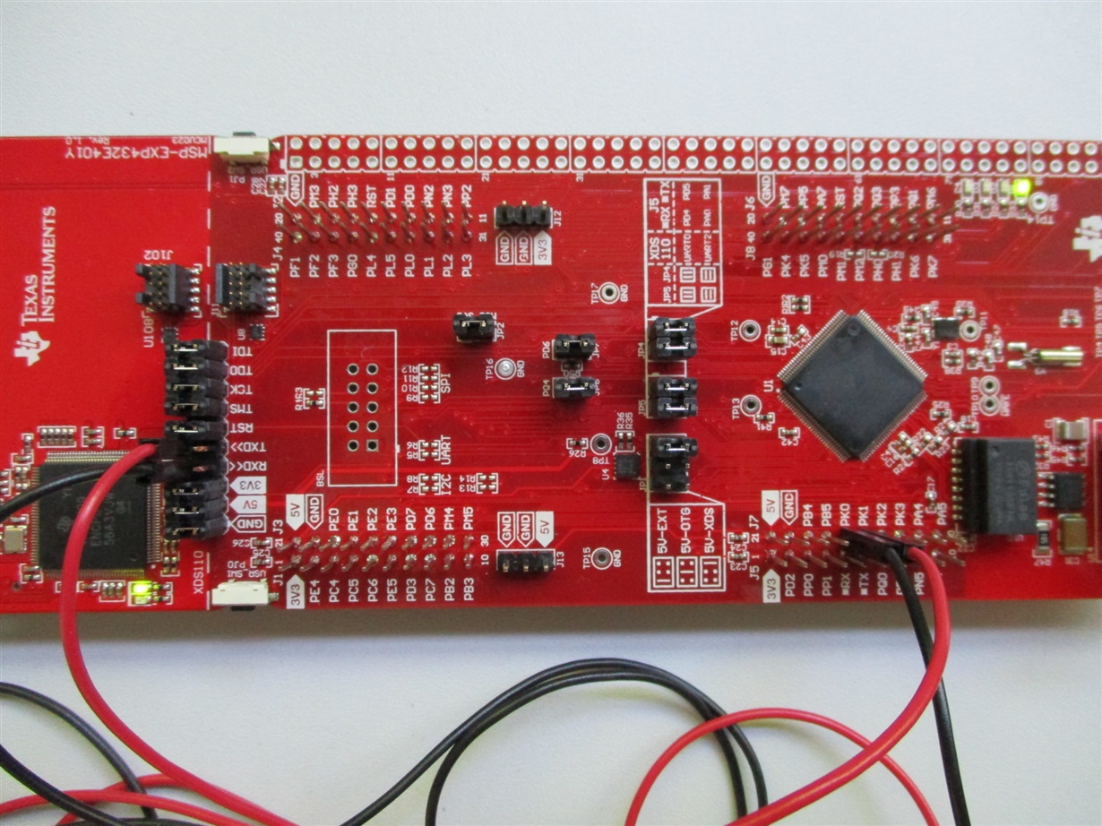

  • Hi Kalyan,
    I just tried the following modification of the uartecho example and it worked:
    /* UART configuration structure */
    const UARTMSP432E4_HWAttrs uartMSP432E4HWAttrs[MSP_EXP432E401Y_UARTCOUNT] = {
            //.baseAddr = UART0_BASE,
            .baseAddr = UART4_BASE,
            //.intNum = INT_UART0,
            .intNum = INT_UART4,
            .intPriority = (~0),
            .flowControl = UARTMSP432E4_FLOWCTRL_NONE,
            .ringBufPtr  = uartMSP432E4RingBuffer[MSP_EXP432E401Y_UART0],
            .ringBufSize = sizeof(uartMSP432E4RingBuffer[MSP_EXP432E401Y_UART0]),
            //.rxPin = UARTMSP432E4_PA0_U0RX,
            .rxPin = UARTMSP432E4_PK0_U4RX,
            //.txPin = UARTMSP432E4_PA1_U0TX,
            .txPin = UARTMSP432E4_PK1_U4TX,
            .ctsPin = UARTMSP432E4_PIN_UNASSIGNED,
            .rtsPin = UARTMSP432E4_PIN_UNASSIGNED,
            .errorFxn = NULL
    const UART_Config UART_config[MSP_EXP432E401Y_UARTCOUNT] = {
            .fxnTablePtr = &UARTMSP432E4_fxnTable,
            .object = &uartMSP432E4Objects[MSP_EXP432E401Y_UART0],
            .hwAttrs = &uartMSP432E4HWAttrs[MSP_EXP432E401Y_UART0]
    PK0 is the receive input of the processor. It has to be connected to the ROUT output of max3232.
    PK1 is the transmit output of the processor. It has to be connected to the DIN input of max3232.
    You could also use the virtual com port of the XDS110. See image:
  • Hi Kalyan,
    one more thing just to be sure: max3232 ground and the MSP-EXP432E401Y ground must be connected. max3232 ground and D-Sub connector ground must be connected, too.
  • Dear Sven Probst,
    Thank you for the continuous support sir.
    Finally it is working. Actually one of the soldering contact was gone bad in the max3232 to D type side.
    Thank you
