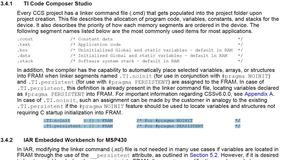

Second, regarding NOINIT, I read SLAA628 - MSP430 FRAM Technolgoy - How To and Best Practices. In section 5.1 it states: (I added the emphasis) "Note that unlike PERSISTENT, variables declared as NOINIT do not get located in FRAM by the default linker command files, requiring a minor modification of the linker command file if such functionality is required." So... what needs to be modified in the link command file and how?

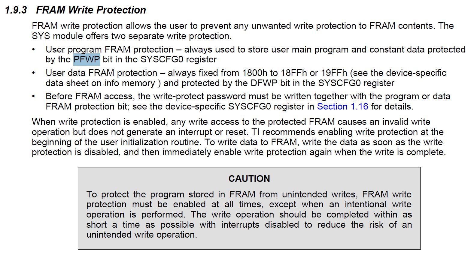

The description says you should disable interrupt while writing to the main FRAM. But then says "This code examples is using DFWP which wouldn't have dangerous." I have no clue what that statement means. The only thing that makes sense to me is that the example claims to be using DFWP.

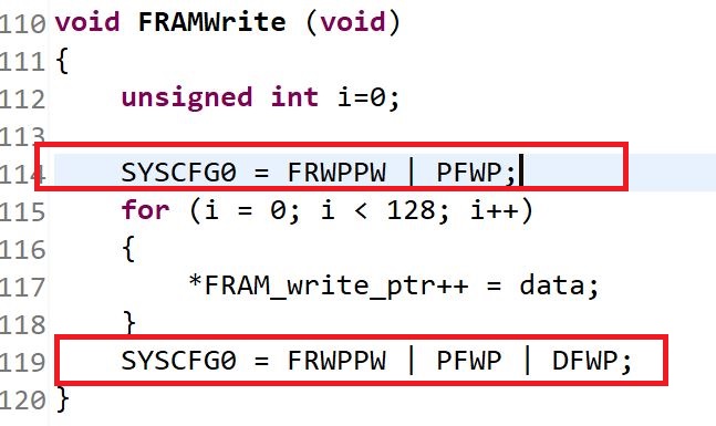

In the FRAMWrite() function it looks like SYSCFG0 unlocks PFWP not DFWP. I thought the clearly written description specifically stated this code was not doing anything with PFWP. So what is going on there?

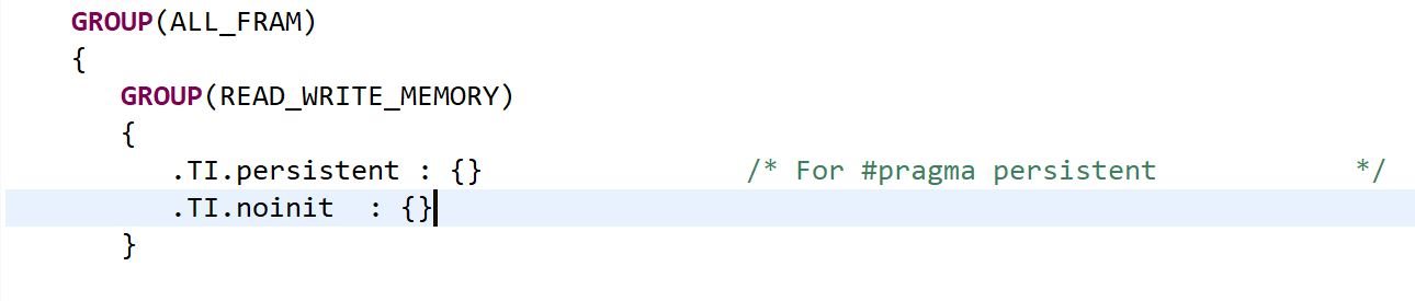

    2. You can find the PERSISTENT and NOINIT section definition at lnk_msp430fr2633.cmd file. In the cmd file, you need delete the ".TI.noinit  : {} > RAM" and add code like below picture, which moves the .TI.noinit section from default RAM to FRAM.
    3. PFWP is for FRAM code memory protection to prevent any unwanted changed of code. DFWP is for FRAM information memory protection. Information memory usually is used to stored user's data. The data changed isn't more dangerous than code changed. Only when PFWP disable, you can write FRAM main memory. So, please enable PFWP as soon as the completion of write. But if interrupt happens at this time, it will expose FRAM at unprotected situation for a long time. Therefore, it's recommended to disable interrupt while code is writing to main FRAM.

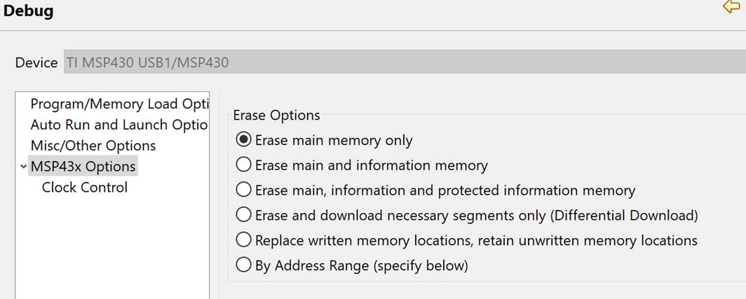

    Yes. I figured this out. I am baffled why the application note I referenced does not include that 2 sentence explanation. Additionally, you forgot to mention that one also needs to disable the "Main memory only" erase option in the Debug tag of the project properties in CCS 8. Again, baffling why TI goes out of its way to hide these critical details. (It is, however, a very effective method to keep new engineers interested in the platform from adopting it.)
    This explanation does not answer my original question. I don't understand why the example has a cryptic statement about using DFWP but the code clearly references PFWP. WHY.? Other FRAM examples I have found use unlock DFWP as expected. Not the one I referenced. WHY. There must be a reason. What is that reason?

    Actually, the sentence “.TI.noint : {} > FRAM” makes “.TI.noinit” varibles locate into FRAM is described in the application note as below. Yes, I forgot to mention that one also needs to disable the "Main memory only" erase option. Thanks for your reminder.  Despite it’s a default setting, anyway, we should keep an eye on it.

    This code example demonstrates writing information memory(1800h-19FFh, protected DFWP), and remind the matters need attention if writing code memory(protected by PFWP). Actually, I didn’t see the thing makes you confused. When writing FRAM information, firstly the code disables DFWP by setting DFWP as 0 (SYSCFG0 = FRWPPW | PFWP) , and then enables DFWP. Anyway, using “SYSCFG0 &= ~DFWP” is clearer for understanding. Thanks for your feedback.
