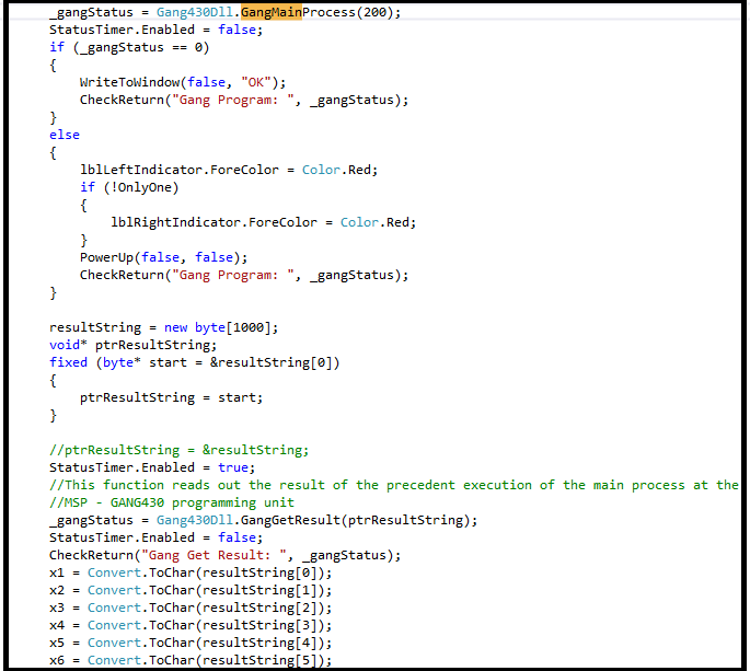

    I am using ‘GangMainProcess()’ function imported from Gang430.dll. Its executing successfully.
    Post this I am executing following code snippet for ‘GangGetResult()’ from the same Gang430.dll.

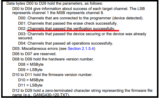

    As per this user guide GangGetResult returns data in the following format:
    I am getting result string in the same format. But the issue I am facing is that its always returning a zero value
    For ‘D02’. Can you please tell us the scenario when this error emerges? Is it related to any device setting?

  • Hello Shradha,
