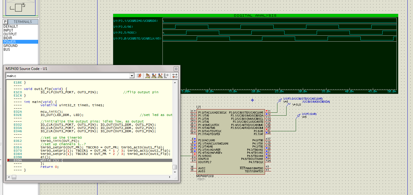

  • much simpler than that: in this case, 3 channel output, each 60 degrees off of each other.
