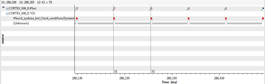

G'Day all,
If you look at the attached Execution Graph screen grab (ignore the arrows!), the time between the measurement marks is reported to be about 27mSec, but I know from external measurements (CRO on a pin being toggled) that the period is 1.68mSec.  It appears the Execution Graph time base is out by a factor of 16!
Any ideas why?

In both those issues there is a comment saying the problem should be resolved in CCS v8.1.
Unfortunately, this problem only appeared for me *after* I installed CCS v8.1 (though colleagues working on the same project have had this issue since somewhere in the CCS v7 series).
