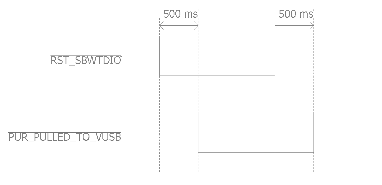

Ideally, I think I could use a delay circuit on RST_SBWTDIO that would control an analog switch which would connect/disconnect PUR to VUSB (see figure below), but I want to be sure that I won't get the "Unrecognized USB device" behavior.
Thanks for the answer.
I now have confirmation of the intended procedure with the push-button, but the document you linked specifies no time constraints for PUR. I also haven't found any in the datasheet of the MSP430F5659. Since I plan to use an analog switch controlled by hardware as in my previous post, I wanted to have the delay needed for proper operation. Is 500 ms ok (see diagram below)?
Also, I'm still unsure why I get the "USB device not recognized" behavior (see my previous post).

Just to let you know that I've received the eval board and I get the same behavior as my PCB (i.e. "Device Descriptor Request Failed" when I connect USB_PUR to VUSB for too long while the device is in reset). It really seems that pulling D+ is what tells the host to send a device descriptor request, which will fail if the device is still in reset. Furthermore, if I release the reset after having received the "Device Descriptor Request Failed" event, then the BSL just does not enumerate and I need to redo the procedure.
Timing seems quite critical for this application, but it's more on the side of "don't press the button too long" instead of too quickly.
