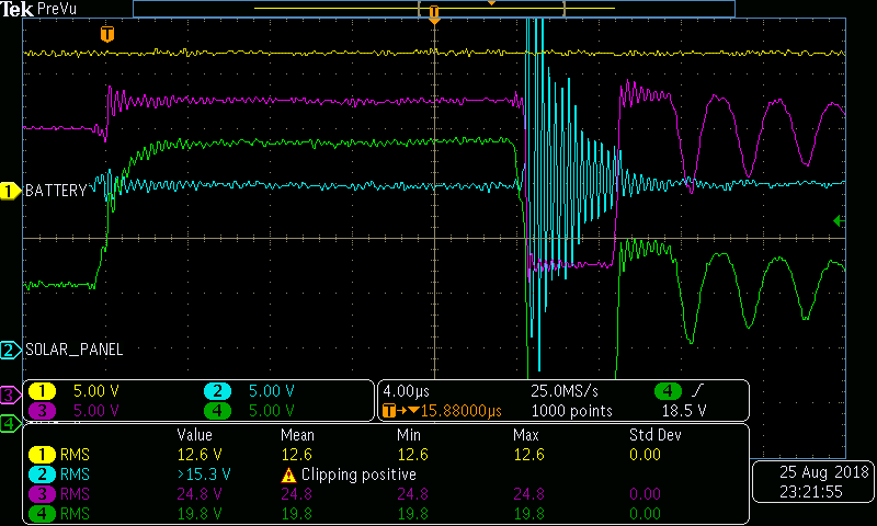

  • I broke last my 2 MSP samples :) BUT in finally I finished to do protection on the last MSP :): short circuit big spikes ...
    can look in the picture:
    Start the DC-DC converter in asynchronous mode and when consumtion is more 500mA(configurable by software) start in Synchronous mode; like picture
    My MPPT look like this:

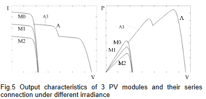

    do you assume an ideal I/V solar cell stack characteristic or do you deal with Global MPPT?
  • I Build Custom I/V. But the best option on this MPPT is can to provide Voltage from solar panel directly to any load (heat element) !!! and not via inverter.(DC-AC inverter). Can be capably to notify via SMS or CALL if someone want to steal your panel solar. Low cost!! < 100$ 200V 50A. Can be change to any another voltage. Ex. 4 series VP 45V *4 = 180V open circuit. I give resistence to heat water and in case if I have power and the battery is full can stock energy to hot water to cold the hows (Air Condition) ...

  • My question was about algorithm and how do you deal with a case when solar cells have a different irradiance.
    It can be caused by water, dust, shade, birds, etc.
  • The alghorithm based on trigger every conversion time of ADC and try to fiend MPPT. Algorithm used "Incremental conductance ".
  • O.K.
    my picture on the right shows 3 power maximums.
    No guarantee that your algorithm would find the best maximum, this one on the right.
    In case of a big disturbance it could go the top in the middle and stay there until a shade or dirt is removed.

  • Try to start from highest possible voltages, close to zero current and then use your algorithm.
    How often such a scan?
    1 time per minute?
    Depends on an environment.
