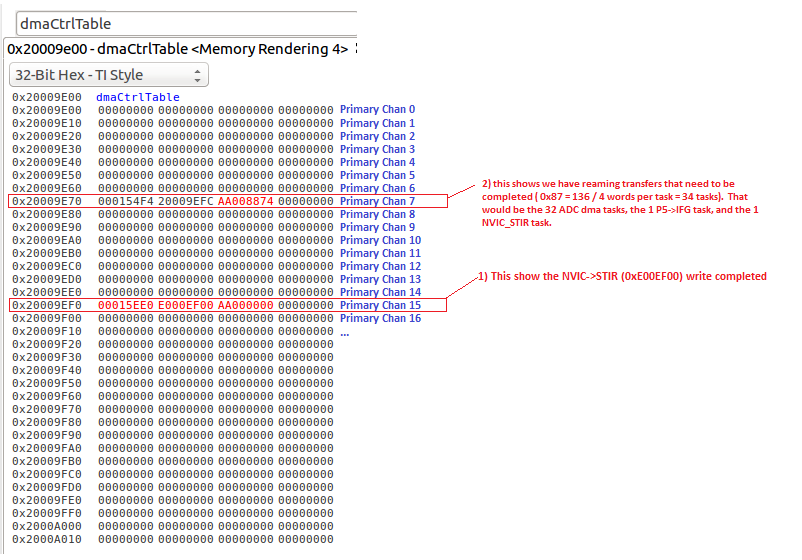

    MY DMA works right up until the Item 2.d. above.
    • The DMA makes it through the first 32 ADC DMA tasks.
    • The DMA Controller sets the P5->IFG = 0x01
    • The DMA Controller generates a SWINT (NVIC-STIR = 55)
    • The PORT 5 Interrupt Occurs for IFG = 0x01, but I get no further DMA Transfers.
    • No Further DMA tasks appear to run.
    There is a clue in my DMA Control Table Which I captured after setting a breakpoint in my port5 interrupt. The Memory browser screen shot is marked up below
    1. You see in the the Pimary channel 7 section we have pending DMA tasks (it looks like 34 tasks if you assume the value is in bytes...0x87 = 136 / 4 words per task entry = 34 tasks)
    2. You see in the Primary channel 5 section we have completed the NVIC write.
    3. The problem is, my DMA appear to be halted...ie no more tasks are running.

    dmaTasks.h
  • Can you change the order of when you move from peripheral to memory scatter gather?
    The last ADC transfer before setting up the GPIO is peripheral and I think it should be memory.   Similarly the transfer to the NVIC before you start up the ADC conversions should be Peripheral.
       DMA_TaskStructEntry(DMA_BLOCK_SIZE, UDMA_SIZE_32,
          UDMA_SRC_INC_32, &ADC14->MEM[0],
          UDMA_DST_INC_32, (void *)&adcDmaBuf0[  31 * DMA_BLOCK_SIZE],
          UDMA_ARB_32, (UDMA_MODE_MEM_SCATTER_GATHER)
           Generate Port Interrupt for ping/pong style interrupt
        DMA_TaskStructEntry(1, UDMA_SIZE_8,
           UDMA_SRC_INC_8, (void *)&forcePortISR0,
           UDMA_DST_INC_8, (void *)&P5->IFG,
           UDMA_ARB_1, (UDMA_MODE_MEM_SCATTER_GATHER)
        DMA_TaskStructEntry(1, UDMA_SIZE_32,
           UDMA_SRC_INC_32, (void *)&swTrigP5Int,
           UDMA_DST_INC_32, (void *)&NVIC->STIR,
           UDMA_ARB_1, (UDMA_MODE_PER_SCATTER_GATHER)
  • Wanting to see if this helped resolve the issue and if you are able to move forward.
    Chris
