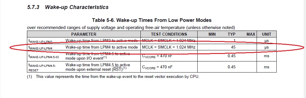

  • All,
    you also can use the AutoWake Up feature which activate the selected clock on request e.g. if a receive is detected.
    However you have to consider the corresponding wake-up times of the selected clock source. This can be checked in the wake-up characteristics of the device specific datasheet.
    Normally we recommend in such use cases to configure the RX pin as GPIO wake-up via port interrupt to ensure clocks are started and the reconfigure to UART and receive data. Alternatively your sender can send dummy data to ensure the wake-up time is achieved. And your receiver rejects data until certain data verify the correct start of information.
  • I have try to send several byte data, by the wake-up characteristics, it should be wake up to get my data in the 2nd byte since after interrupt, I have change to AM mode (i.e. : 1 byte time = 1/19200 x 10 bit = 520us). However, the result is I miss many bytes. Can any setting to flush the buffer, reset the control flag or error flag?  Thanks!

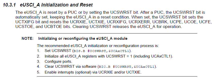

  • Hi Hung,
    thanks for the code! Can you please follow the recommended initialization in way to change the GPIO to UART function according the sequence below and try again?
  • Thanks Dietmar,
    it seem better now:
    void chg_io_to_uartrx_pin(void)
    GPIO_disableInterrupt(PORT_UART, P_UART_RX_Pin);
    UCA0CTL1 |= UCSWRST; // Hold eUSCI in reset
    GPIO_setAsPeripheralModuleFunctionInputPin(PORT_UART,P_UART_TX_Pin | P_UART_RX_Pin,GPIO_PRIMARY_MODULE_FUNCTION);
    // Configure and enable the UART peripheral
    EUSCI_A_UART_init(EUSCI_A0_BASE, &uartConfig);
    EUSCI_A_UART_enable(EUSCI_A0_BASE);
    UCA0CTL1 &= ~UCSWRST; // Release from reset
    EUSCI_A_UART_enableInterrupt(EUSCI_A0_BASE,(EUSCI_A_UART_RECEIVE_INTERRUPT));
    void chg_uartrx_to_io_pin(void)
    P1SEL0 &= ~(P_UART_RX);
    P1SEL1 &= ~(P_UART_RX);
    GPIO_clearInterrupt(PORT_UART, P_UART_RX_Pin);
    GPIO_enableInterrupt(PORT_UART, P_UART_RX_Pin);

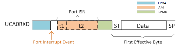

  • Hung,
    pls ensure you apply following procedure:
    1. Disable the UART function and then configure the i2020 UCA0RXD to Port Interrupt function before running into LPM4
    2. Trigger the i2020Port Interrupt by an Port Interrupt Event on UCA0RXD to wake up MCU
    3. In the Port ISR
    t1: Configure MCU to AM mode to make sure the clock is activated
    t2: Set MCU to run into LPM0 mode when exist the Port ISR, then enable the UART to change UCA0RXD function for the first effective byte
    Note: a. Make sure the UCA0RXD keeps the state between the Port Interrupt Event and ST of the First Effective Byte
             b. Make sure the Port ISR is complete before the ST(Start Flag) of the First Effective Byte
